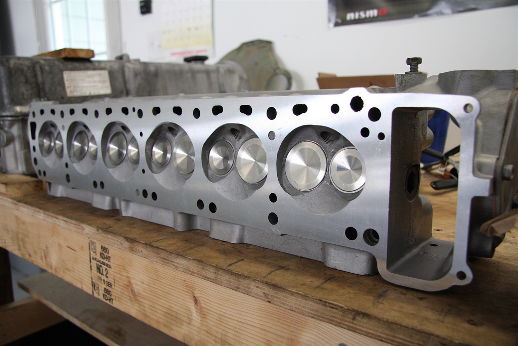

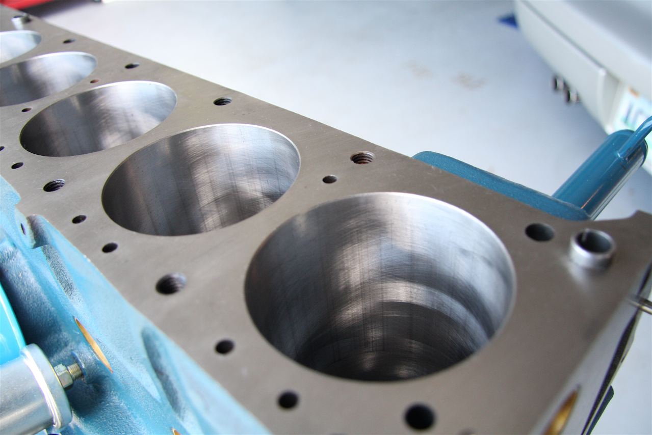

FYI.......An example of Carlos' work at Citizen's Machine Shop.......An E31 with hardened seats, bronze valve guides and L28 exhaust valves. The block is an L24 bored .040 over. He's a real perfectionist.

Gary.....When I get Carlos to do my head work, I provide all the parts......He charges $450.00 for the head ( includes cleaning the head, installing new hardened seats, new guides, valve job and surfacing the head ). Re the block.......He'll hot tank the block, bore to your specs, hone the cylinders and install brass freeze plugs (brass freeze plugs included) for $200.00. For an extra $50.00, he'll paint the block original Datsun blue. He will obviously charge shipping and handling charges if not hand delivered. Guy
