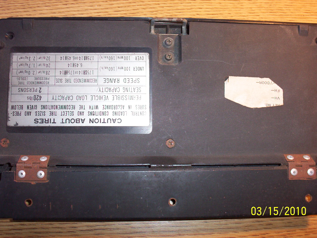

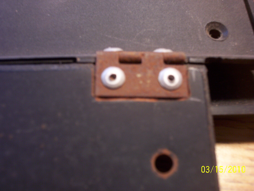

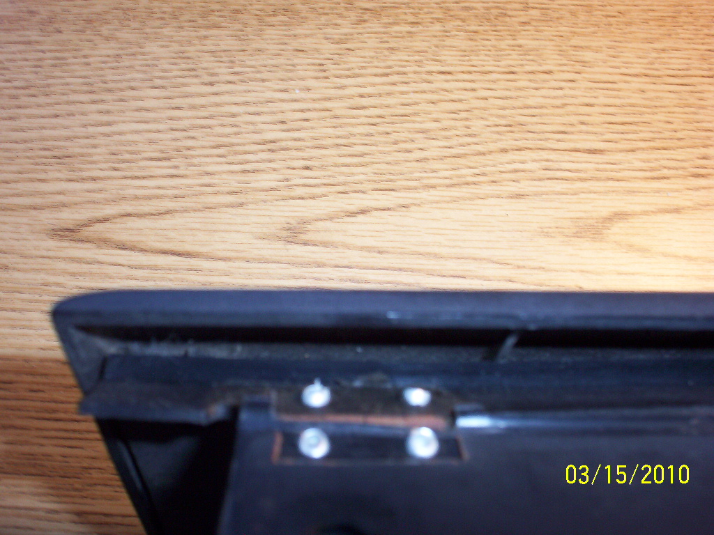

I have a door that I fixed some time ago. I used some small (1" wide) hinges and pop rivets. You just need to cut out two areas on the metal sleeve(?) that goes over the section of hinge attached to the dash so the hinges sit flush. Sorry about the rust, but this has been sitting in my garage for a while.
