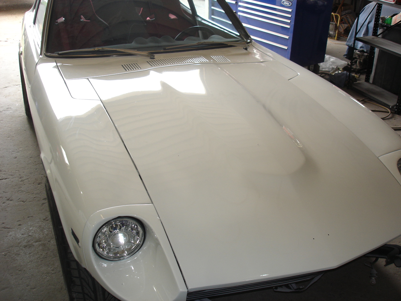

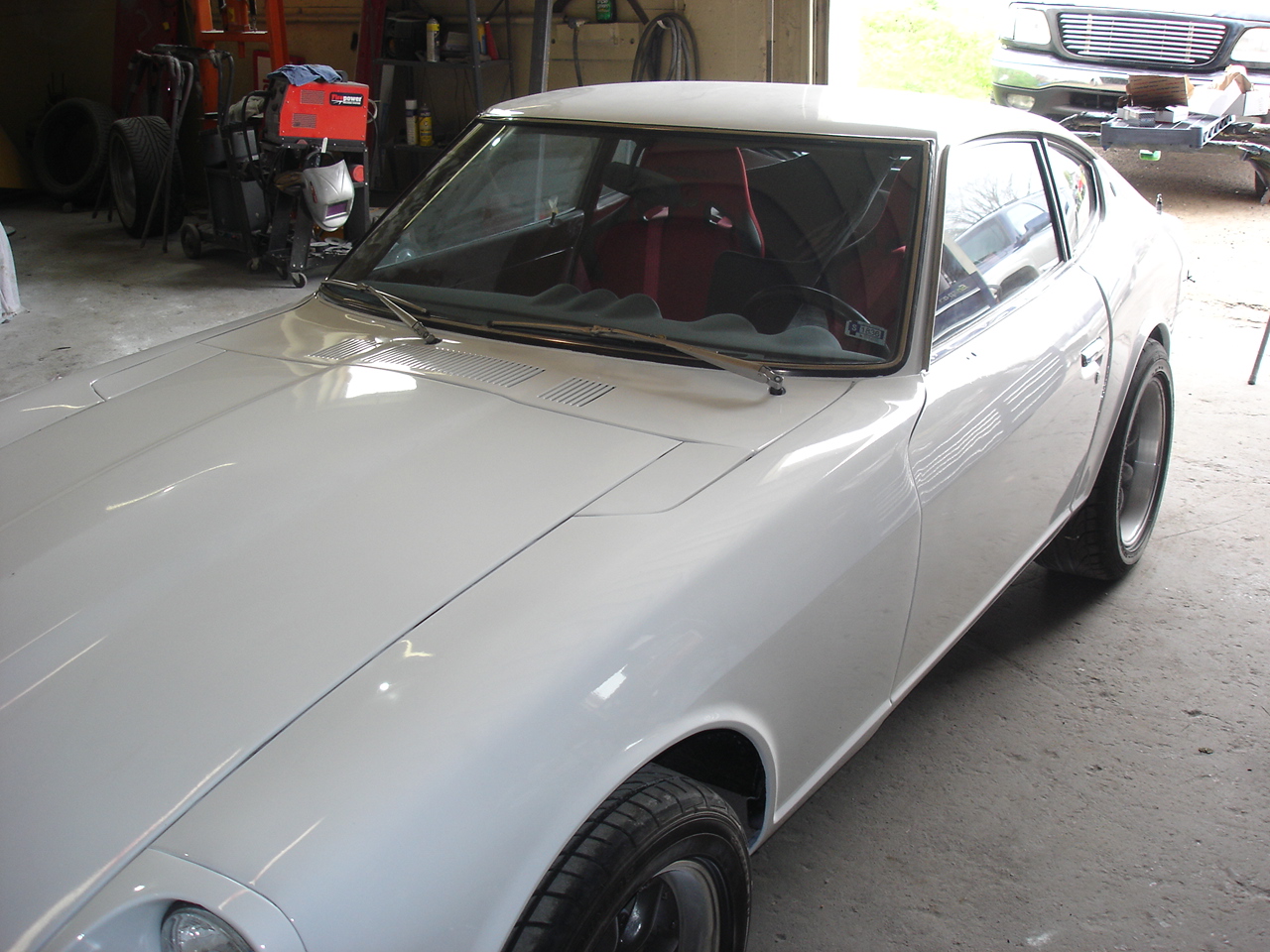

I got to see my car for the first time with it's new coat of paint. It still needs the jambs done and the final sand and buff. I'm told that by the end of the week it should be done. I also started it for the first time since I turned it in for restoration work seven months ago. The body guy has been starting it all along, but I just had to hear it again. Can't wait to get it back!

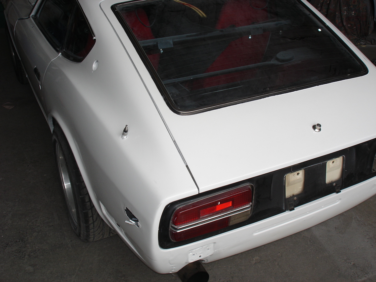

Last picture was my attempt to capture the ghost flames that are there. It kind of looks like finger smears in the picture. I'm not sure if anyone else will be able to see them. Then again, that's part of the reason they are ghost ones: added detail that is hiding until the lighting conditions are just right. I like them!

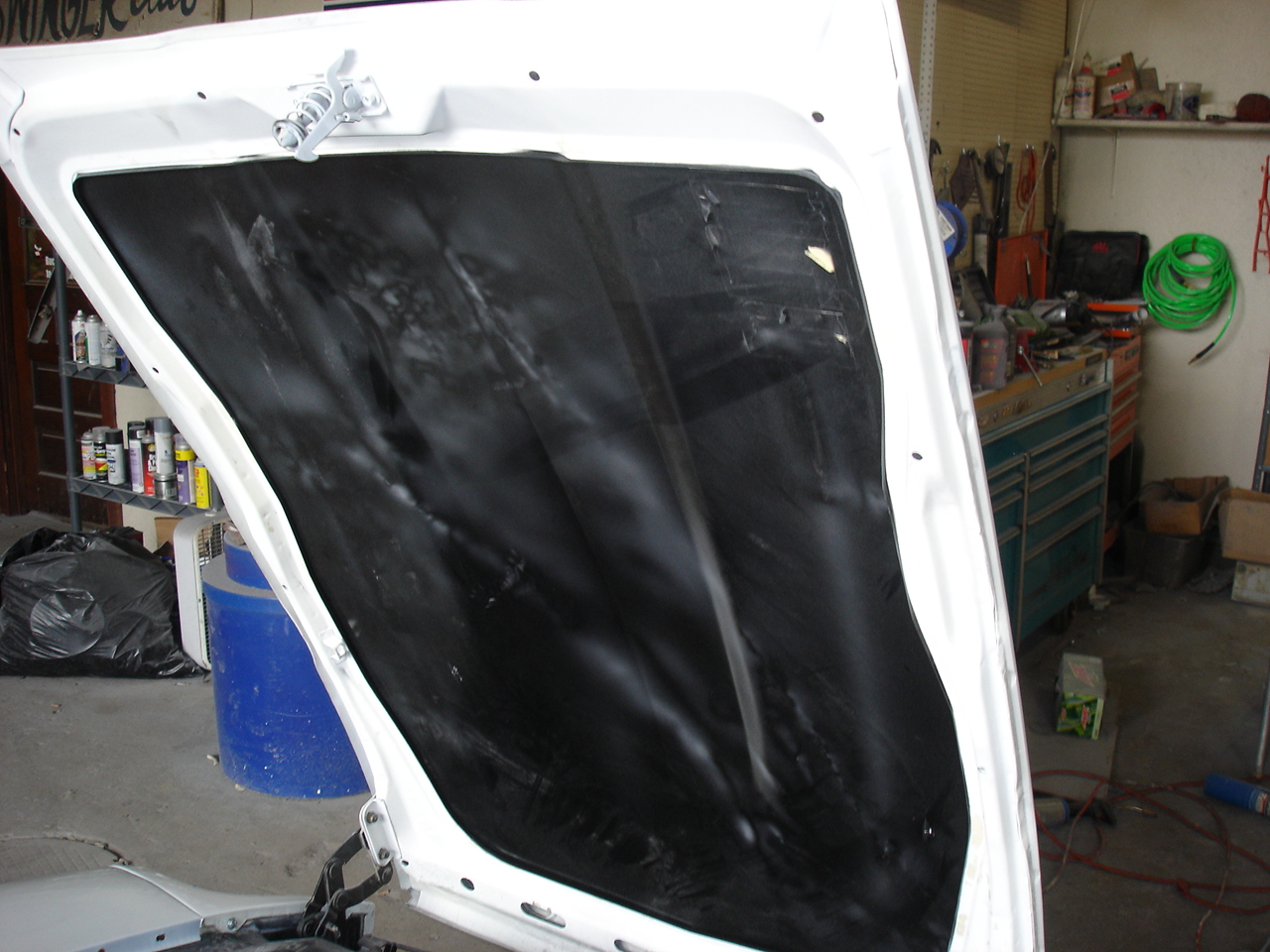

Last few days, installed new hood release, cleaned the hood latch and reinstalled, took off grill and loosened hood hinges to unjam hood!:angry: Fiddled with hood adjustment for an hour.Bled brakes and clutch, adjusted slave cylinder throw and clutch pedal (both out badly) Discovered what looks like a shotgun hole in passenger footwell! :ermm:(will post a pic,very strange)Will drive to work tommorrow:D
Sounds like the day from hell except for the last line.

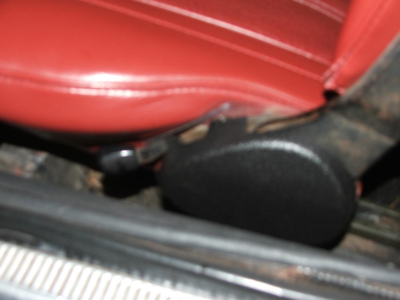

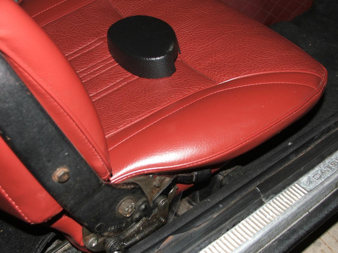

MotorSport Auto.
They just started selling this item a couple of months ago in there discontinued items section.
It took a while for me to convince a cheap Dutchman to pay what they are asking for two bits of plastic.
Perfect fit though. Can't complain about that!
Casey
$63? Yeah...that's hard to justify for me too.

epsark...your paint job looks great!

Thanks about the paint. I can't wait to get the car back and see it finished finally! I will post pics once I get it back. Hopefully before this weekend, the weather is supposed to be great instead of all the cool days, overcast and rainy days we have been having.
