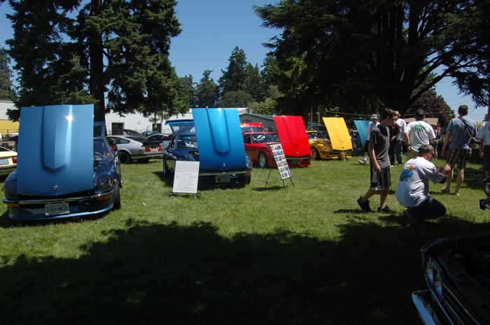

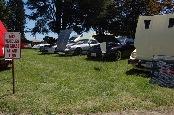

June 14, 201014 yr comment_322503 For those of us in Oregon and Washington, one word is enough to describe what I did today - Canby. I loved the sign they parked us behind (in the second picture)! Link to comment https://www.classiczcars.com/forums/topic/35090-what-i-did-today/?&page=5#findComment-322503 Share on other sites More sharing options...
