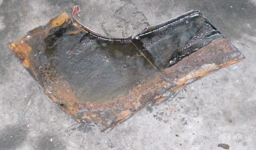

March 23, 201015 yr comment_313381 Hey Rich!On those doglegs, I would recommend you cut out the entire panel and put in a new one versus brazing and grinding down. There's bound to be more rust behind there that isn't through yet. Don't want you to go to all the work of painting the car to have new bubbles form a year or so later. In fact, they might even form sooner when they wet sand down the car. Try tabco for the replacement dog legs. Not very expensive and well worth not having to worry later.Bob Link to comment https://www.classiczcars.com/forums/topic/35102-lets-paint-it-yellow/?&page=2#findComment-313381 Share on other sites More sharing options...
March 23, 201015 yr comment_313409 My painter insisted we change the doglegs "just to be sure". We used the ones from Black Dragon and he was very satisfied with the fit. They were about $54 each. It took about an hour on each side to remove and replace. You can see in the picture of one the amount of underseal that had been in place but you can see to the surface rust around the edges. There was no signs of rust on the outside however. Link to comment https://www.classiczcars.com/forums/topic/35102-lets-paint-it-yellow/?&page=2#findComment-313409 Share on other sites More sharing options...

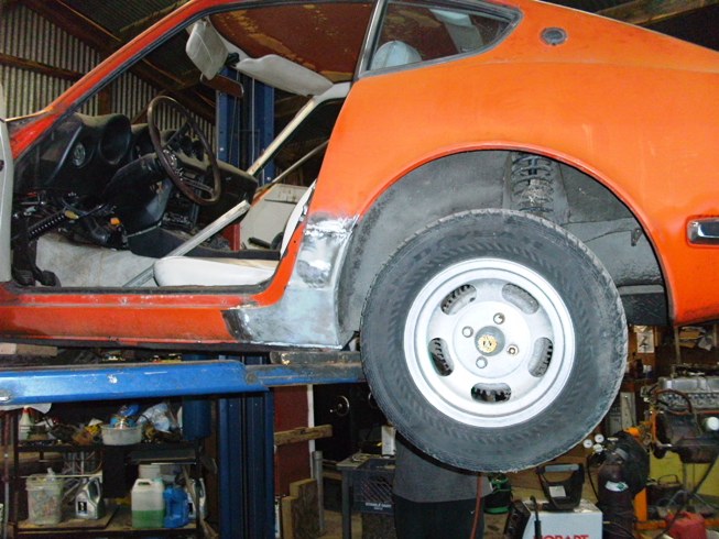

March 29, 201015 yr Author comment_314109 Boy, this is slow going. Hours and hours of sanding. It's not bad, but it seems the more I work on this, the more I find stuff I don't like. There are quite a few dents on the underside of the panels where the PO placed the jack to change tires. Didn't catch those earlier. I ended up replacing a section of the passenger side dogleg. Fortunately the PO also gave me the Tabco panels that he had puchased for the car, both right and left side. The drivers side was pretty clean. The passengers side was pretty bad. Again, worse than I had expected. My son helped out with sanding the engine bay while I tended to the doglegs and the jack dents. I have most of the body dings fixed, but have not even started cleaning up the door jams and hatch are. That will be a chore. So, looks like I will miss my April 3 date to Maaco. Now shooting for the April 10. I opted to use the all metal body filler versus the regular bondo. Its pretty nice to work with and seems to dry harder. Thanks for the input guys, Rich Link to comment https://www.classiczcars.com/forums/topic/35102-lets-paint-it-yellow/?&page=2#findComment-314109 Share on other sites More sharing options...
