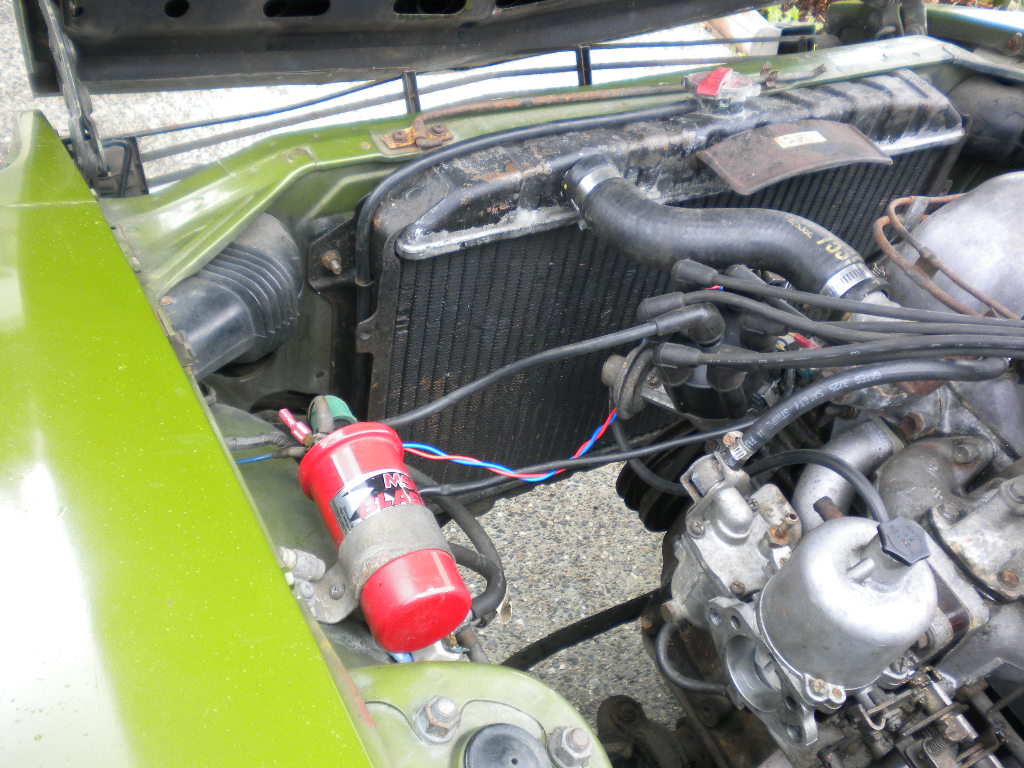

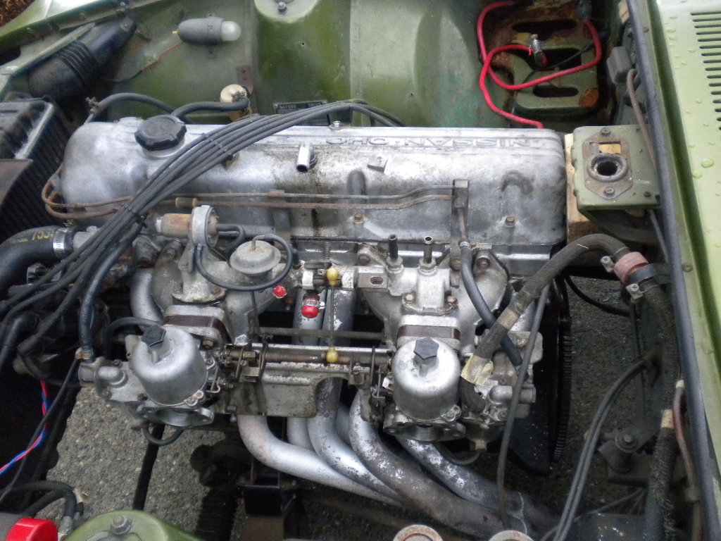

So I made a call today to Adam in Everett. His RB26 is in Customs so he needed to get the stock motor out of his 240Z and sold. He sold me the motor, Trans, radiator, Blaster 2 Coil, basically a full running drivetrain with all the goodies, for $200. AND!!!!!! He even brought the cherry picker with him and helped me install the motor right there.
So tomorrow, I'll take the flywheel down to have it resurfaced and after that, install the flywheel, New Sach's Clutch (that I bought for the 70') and the tranny. Just gotta find the crossmember and a good driveline. Then I'll check out the electrical system and see what I can do about starting it this week. YEAH!!! Aaron (The P.O.) is gonna POOP PURPLE TWINKIES!!!!

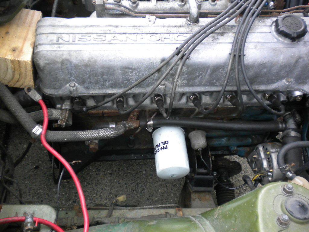

Got the flywheel on, as well as the new Sachs clutch, pressure plate, throw-out bearing and guide. Me and Tyler got the tranny in pretty easily, considering we were on a hill and the damn jack kept rolling down the hill, with the tranny attached. Had to use the 260Z's slave cylinder, stainless clutch line and clutch fork. But that's OK, the motor aint going into the 260Z any time soon.
So tomorrow, I'll finish bolting up the driveline, blow out the fuel lines and instal the new fuel fiter and give her an oil change and top off the tranny fluid as well. Then I gotta bleed the brakes, check the electrical system and with any luck, FIRE IT UP for the first time in 12+ years.

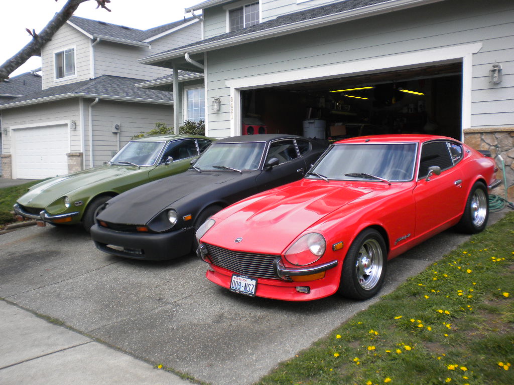

Also had time for a quick family photo with Tyler's Z as well. And that's a Subaru 60 amp IR alternator. Aparently, it's a direct bolt in.
