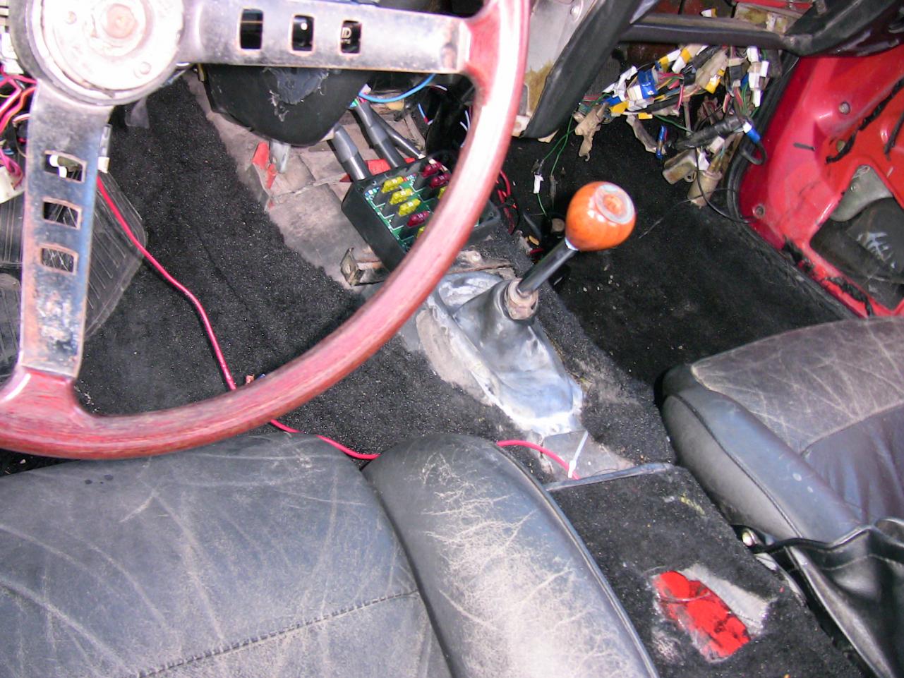

Posted March 19, 201015 yr comment_312947 So my z sat outside, semi-neglected, in the driveway for 10 years. I've recently driven it across canada, and figure that it could use a rust check.It will be another two years before I graduate, recieve a rather large promotion, and am able to afford some nice sound deadening and insulation. I figure if this is going to be my daily driver in the summer, we better stop thinking about weight. I can buy a 240z to SCAA modify at a later date, and worry about fibre-junk and drilling my alumimum blots out at a later date.I have more important things to spend my $ on while in college (electrical, gas, and food [in that order]). But I can't leave what I know is certain to be rust, untreated and wet under the floor below me... so I decided to strip the interior to bare metal, then POR-15 it and live with a noisy interior for a couple years.The seat's can't come out until the new ones get here, but I got eager today and ripped the drivers side carpeting out, from in front of the seat to the firewall. The floor panal had two well-rusted grooves which facilitated easy removal of the bottom layer of sound deadening. Where it was not rusted below, I tried a drill with a wire head on it. I was using it to remove rust, but instead of melting, all the deadening came off in tiny plastic flakes. If you're having a hard time removing non-tacky deadening, the drill worked wonders for me.The rust is all surface (so far), and it's all going to be gone by the time I POR-15 it. I am wondering what to use overtop of the POR. It should be cheap, glossy, and preferably clear. I know the POR is supposed to be good by itself, but for some reason, I think a clear coat (or gloss finish) will prevent moisture more than the matte POR finish. What do you think? Edited March 20, 201015 yr by fiveleaf Link to comment https://www.classiczcars.com/forums/topic/35105-sound-deadening-removal-floor-panal-rust-por-15-question/ Share on other sites More sharing options...

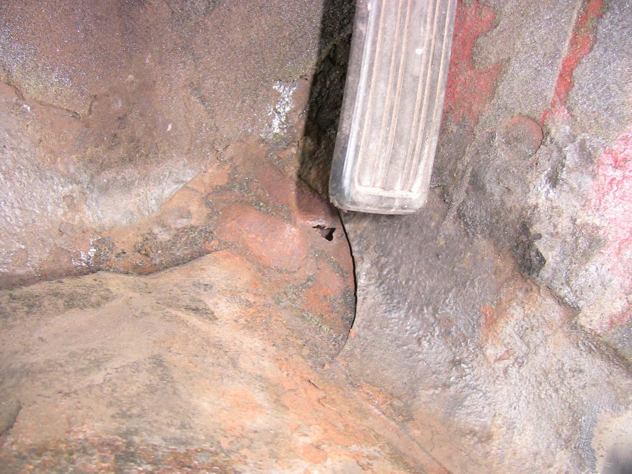

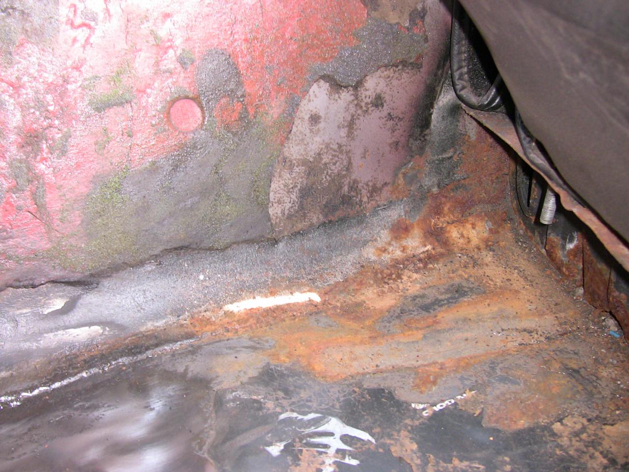

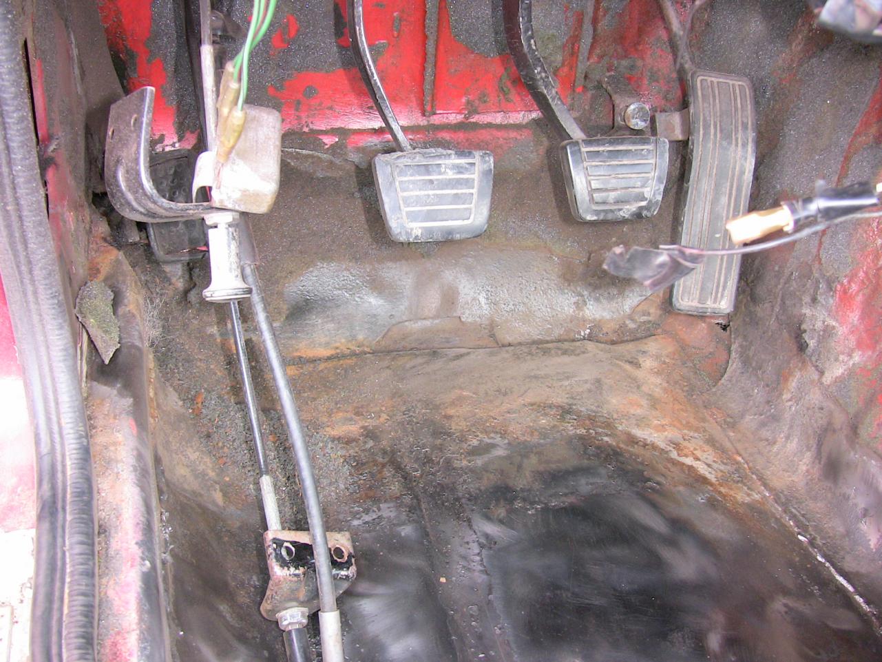

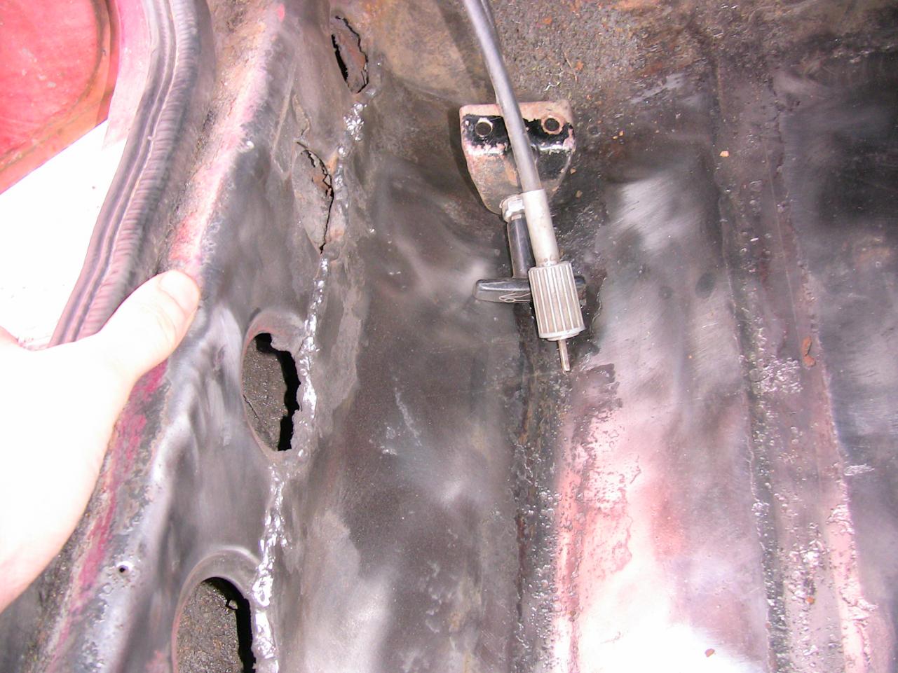

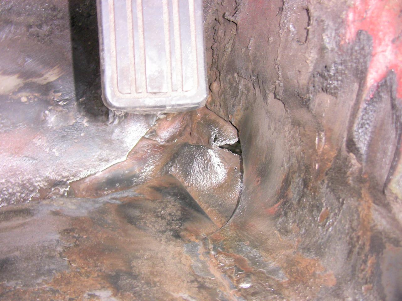

March 20, 201015 yr Author comment_313080 Holes near the taillights are to suck the fumes in, which has the effect of freeing up the passenger space of anything female. I just ordered 4 quarts of POR-15, for $160, two silver and 2 black. I also found some paint-over gloss black POT-15 topcoat. The two products should have a nice effect when I'm done. The inside of the dash, passenger dogleg, and eventually the rear hatch will also need to be done. Reccomendations on the hole? cut out a patch and weld it back in? I've never done any of this before, just seen pictures. Here's after some sanding... or cheap $30 drill + zapstrap "ON" + wire brush Also, starting pictures have been added to my second post. Edited March 20, 201015 yr by fiveleaf Link to comment https://www.classiczcars.com/forums/topic/35105-sound-deadening-removal-floor-panal-rust-por-15-question/#findComment-313080 Share on other sites More sharing options...

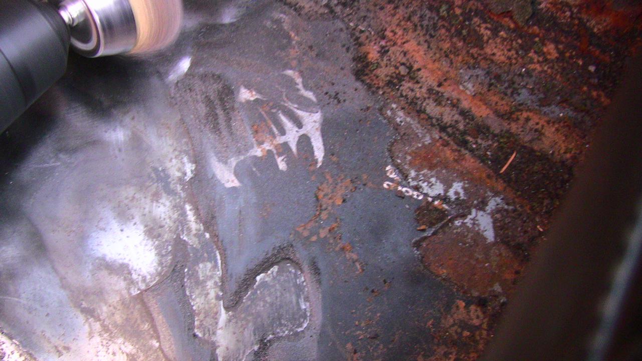

March 20, 201015 yr Author comment_313132 There must be a faster way to do this. I'm searching for a tool that does this job better than a drill and wire brush attachment. You can see it in picture #5 (above).The wire brush also wear's down faster than I would imagine. Especially in the non-smooth areas (under the pedals).I tried to dremel it with a wire attachment and wore that little brush out in about 120 seconds. Edited March 20, 201015 yr by fiveleaf Link to comment https://www.classiczcars.com/forums/topic/35105-sound-deadening-removal-floor-panal-rust-por-15-question/#findComment-313132 Share on other sites More sharing options...

March 21, 201015 yr Author comment_313149 Money is not an object for rust-proofing. I'm still going to wait on the sound deadening until I graduate. There are more important things to do than sound deadening anyways. My order for POR-15 had already been paypaled, but was just refunded because of spelling on the street name. I'll look into the Zero Rust; thanks.Until then, I could really use something more effective than a wire wheel for saning. I'm thinking a grinder attachment...It also looks like the floor panels were at one time painted with a really tough topcoat, which looks good until you grind it hard for about 15-20sec, when it reveals the rust below.Another issue is the hard-but-tacky sound deadening on the firewall and centre console to the floorpanels. Too soft for the wire brush (gums it up), too hard for a scraper. About 1/4 to 1/2 inch thick.I will need to remove the pedals to repair to weld over the rust hole on the driver's side. I couldn't find any screws or bolts, looking with a mirror. I have new pedals coming. Is there a trick to getting these off? This carpet kit is cheap, and not what I will end up using. For $150, I think I'm going to temp install it with minimal ammounts of glue for the next couple years, then give it away when the time comes for another interior job.hmmm... Need to pick up the new seats/dash cap/anti-rust before taking eveything apart. I don't want my seats and dash out while waiting for parts. I still need to daily drive it! Edited March 21, 201015 yr by fiveleaf Link to comment https://www.classiczcars.com/forums/topic/35105-sound-deadening-removal-floor-panal-rust-por-15-question/#findComment-313149 Share on other sites More sharing options...

April 18, 201014 yr Author comment_316276 I'm going with POR-15, with a glossy black POR topcoat to go overtop.I've been sanding for the last week now, and am almost finished the entire passenger's side.Seats/dash/console are all out, I'm mostly using an angle grinder. I picked up a 7" giant makita grinder to make the drivers side go faster. This grinder with a wire wheel attachment (and no guard) can remove sound deadening like no tomorrow. Most of the work is being done with the smaller shop angle grinders, and a 4.5" sanding disc. The kind that are thick, with layered sandpaper. Those things last forever.The transmission tunnel and firewall had some crazy spray-on stuff that proved impossible to sand off. It was thick, like tar, and would melt before flinging off the angle grinder. I was in a t-shirt the first day and got a large piece of the molten stuff, which lit on fire mid-flight, on my forearm. Never again.I was actually about to give up on it... until a hammer and chisel worked their wonders. FAR faster than the sanding method. And a good thing -- the front of the tunnel came off with chunks of rust on the bottom. All surface. Pictures to follow! Link to comment https://www.classiczcars.com/forums/topic/35105-sound-deadening-removal-floor-panal-rust-por-15-question/#findComment-316276 Share on other sites More sharing options...
