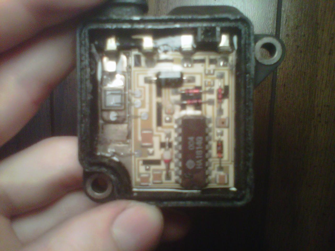

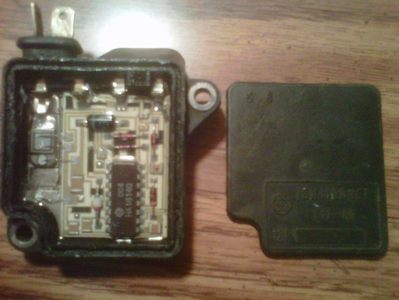

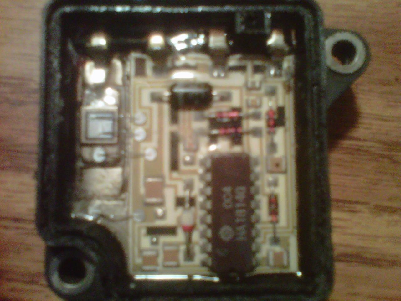

I pulled apart my oldest E12-80 ignition module and took some pictures. I have no idea what any of it does; but for those who may know and may be interested this is what the inside of a $150 dollar module looks like. At least that's what I paid for the Wells replacement from Autozone.
E12-80 ignition module internals
