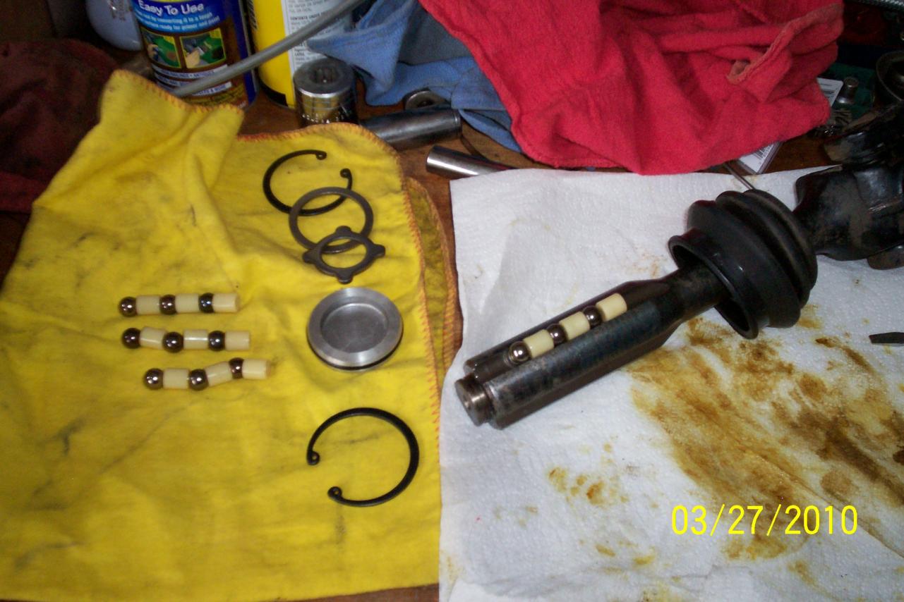

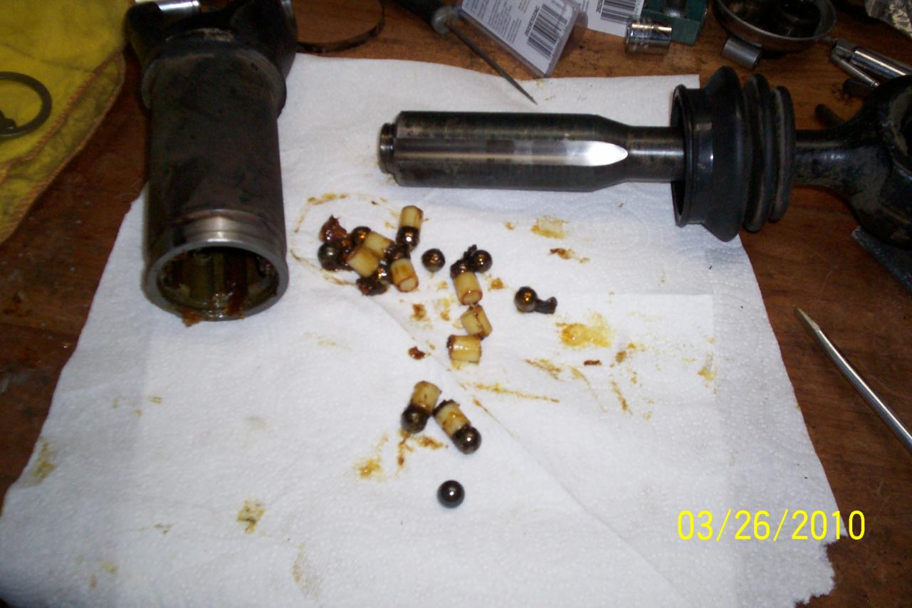

March 28, 201015 yr Author comment_314050 Moogrr,Great post. I have finally undertaken this job. Just as you described. Here is an early picture. When it is all done, I'll post the final result.Mike Edited March 28, 201015 yr by mbarjbar forgot picture!! Link to comment https://www.classiczcars.com/forums/topic/35151-drive-shaft-servicing/#findComment-314050 Share on other sites More sharing options...
March 28, 201015 yr Author comment_314052 Here are some pics. Link to comment https://www.classiczcars.com/forums/topic/35151-drive-shaft-servicing/#findComment-314052 Share on other sites More sharing options...

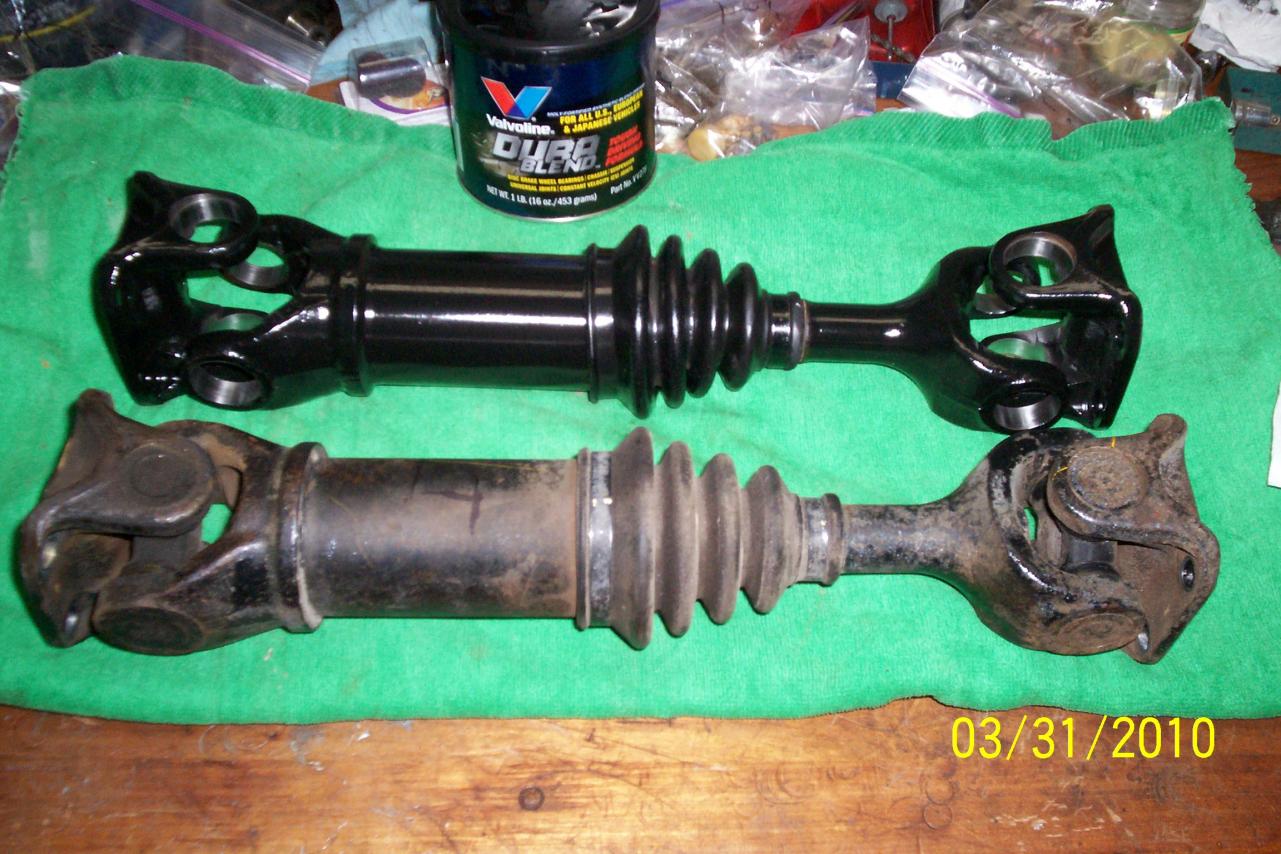

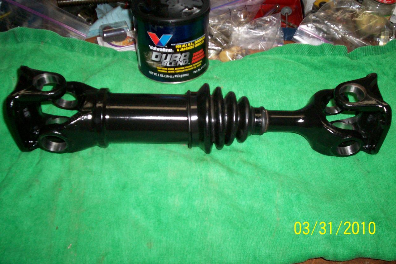

April 2, 201015 yr Author comment_314630 OK, I did it! What a bitch to get those balls and spacers back in! Here is the finished piece. Mike Link to comment https://www.classiczcars.com/forums/topic/35151-drive-shaft-servicing/#findComment-314630 Share on other sites More sharing options...
April 2, 201015 yr comment_314680 Nice pics-shameless plug for the Valvoline. Link to comment https://www.classiczcars.com/forums/topic/35151-drive-shaft-servicing/#findComment-314680 Share on other sites More sharing options...
April 3, 201015 yr Author comment_314733 Thanks, I like the Valvoline, except that it is gray-black. I am going to tackle the other one. This time I think I will try to replace the balls and spacers to the groove they came from.Mike Link to comment https://www.classiczcars.com/forums/topic/35151-drive-shaft-servicing/#findComment-314733 Share on other sites More sharing options...
