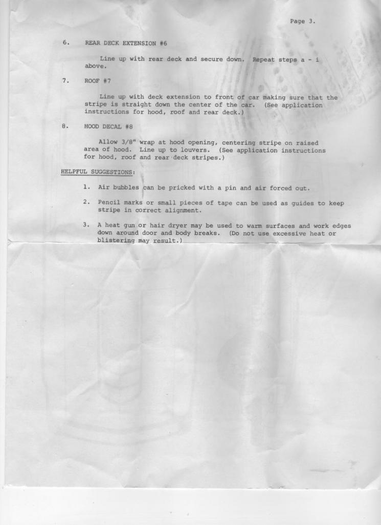

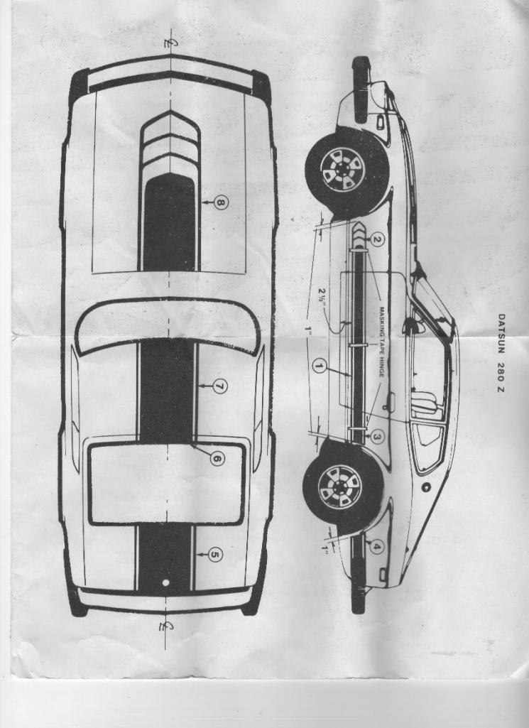

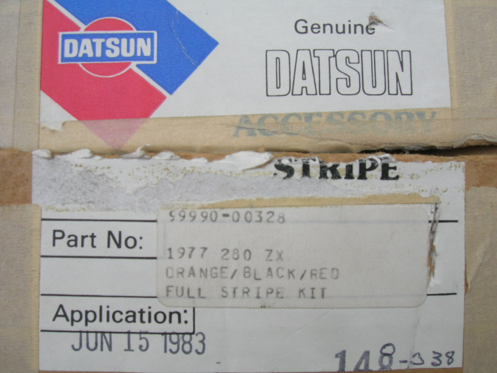

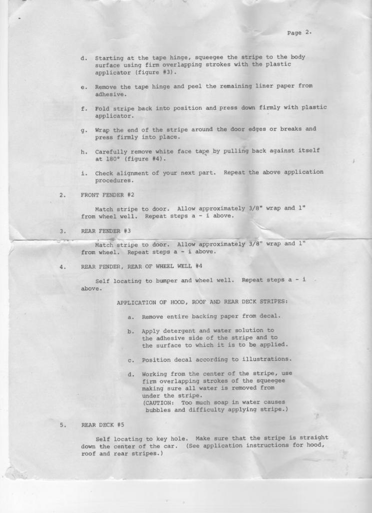

April 28, 201015 yr comment_317425 Update on ZZZAP decal. This has been a major work trying to recreate what is on the car........Finally, it appears very very close to original ones. Color matching was the hardest part in this journey. We did lots of research and also used less faded area such as side of the body for correct color reference. This particular material is the ones they you to car-wrap, and it is also has 1 more layer of clear for scratch and UV protection. (Very hard) Well, this is as close as original one until someone comes up with NOS one.......... I just finally out partially used NOS ZZZAP decal in a box. So I would like to share its installation/instruction paper with you all! Link to comment https://www.classiczcars.com/forums/topic/35211-zap-decals/?&page=4#findComment-317425 Share on other sites More sharing options...
