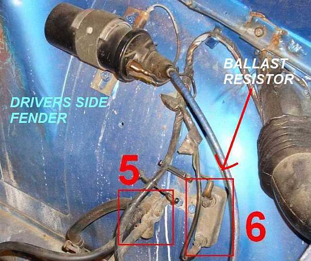

March 30, 201015 yr Author comment_314254 Ok, ballast resistor is located near coil? Can some1 give picture, ill remove it and change if i can find a proper fit from local auto store. Ignition was ok last time i started Z, but i think the lock was already worn out then, i just noticed it yesterday. Maybe the problem isn't there indeed. Thanks already Link to comment https://www.classiczcars.com/forums/topic/35248-240z-starts-but-dies-as-soon-key-released/#findComment-314254 Share on other sites More sharing options...
March 30, 201015 yr comment_314274 I'm not sure but I think this is a 240z. The ballast resistor shouldn't be hard to find at any rate...just follow the wire down from your coil. Link to comment https://www.classiczcars.com/forums/topic/35248-240z-starts-but-dies-as-soon-key-released/#findComment-314274 Share on other sites More sharing options...
March 30, 201015 yr Author comment_314281 Thanks mate, it seems to be 240Z, at least it really looks like one. Ok, is there any DIY method to revive that ballast resistor or should i just try to find new one? Link to comment https://www.classiczcars.com/forums/topic/35248-240z-starts-but-dies-as-soon-key-released/#findComment-314281 Share on other sites More sharing options...
