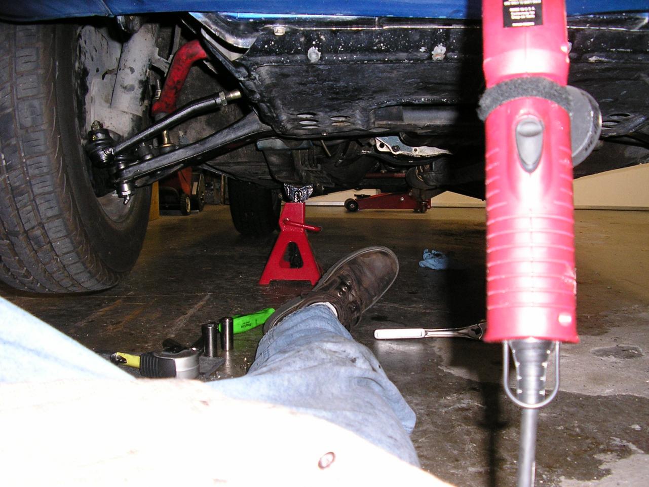

I dug through my old photos. I think this was one of them you were looking for. Sorry but I was only able to find just the 1 and it's for the front when I did my ball joints and tie rod ends. Hope this at least helps give you a better idea of the front jack stand locations. Excuse my big foot in the way :laugh:
Edited by DatsunZsRule
Thanks!! I must admit I'm paranoid about the frame rails since they look hollow and fairly fragile since almost every z I've seen (including my own) has a few good-sized dents banged into the rails. My jack stands are the same time as yours with the "Y" head, so it looks like I'll be ok.
