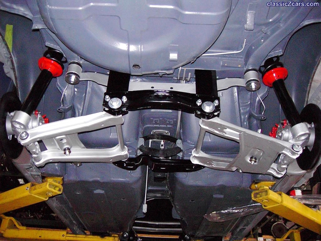

April 4, 201015 yr comment_314874 WW2Winger is correct... I observed the same when looking under mine prior to bushing, coils/shocks were being planned to be replaced....and since my steering wheel was always turned slightly to keep the car going straight down the road. I knew it was dog tracking slightly.... I've attached a photo from this website of a New Rebuilt stock 240z. It may help you better understand the suspension. Here's my rear end rebuild and dog-tracking fix. Read post #77 and beyond as it's my experience on what I did to correct the dog-tracking. My rear end also is much more quite as I'm sure I was dragging the tires: http://www.classiczcars.com/forums/showthread.php?t=33630&page=4 What I found was that my rear end was twisted such that the driver wheel (-0.01 degree, toe-out) was 3/8 inch further back than the passenger wheel (+0.46 toe-in). After all my work they are now square and my toe-in for both rear wheels is in spec and equal for each rear wheel.... around 0.21 degrees toe-in for each wheel if I recall. Hope this helps....and good luck. Edited April 4, 201015 yr by moritz55 Link to comment https://www.classiczcars.com/forums/topic/35330-does-my-car-have-two-right-side-lower-control-arms-in-the-rear/#findComment-314874 Share on other sites More sharing options...

April 5, 201015 yr comment_314930 It sounds like your vertical braces (the 2 black plates in the photo in my prior post above) which come down from the body and attach to the cross member are bent. Your driver side may be bent forward and your passenger side is bent back causing the rear to be slightly rotated to the right.Also for the R200 - the mustach bar is reversed such that the space between it and the black vertical braces I referenced is barely 1/4 inch .. maybe a little less. Check this to see how bent they may be.If you are handy ... drop some plumb lines to your garage floor (plumb line I used was twine with weight on it like such as a fishing 2oz or 3oz sinker). I put tape down on the floor so I can mark the plumb points easily. If you also have a Carpenter Square or Tee Square it will help so you can get some right angles off your plumb marks on the floor from the car body/frame and compare it to your rear transverse link left and right bolt positions. Just be symetrical on where you make your plumb drops off the body - from the same position on right vs left side. Two good body plumb reference points are the left and right mustach bar bolts since they attach to the body. If you drop them down to the floor... and connect the two points with a line.... Then .. drop two plumb points from the center of the rear bolts on transverse link that attaches to the two vertical braces... connect these two points with a line also ..Now with these 2 lines... if your rear end was square they should be parallel (have equal distance between them)... if they are not - you can calculate the rotation angle and toe-in differences using the Carpenter Square and simple Trigonometry.Here's some easy trigonometry info: http://wright.nasa.gov/airplane/trig.htmlHere's a sine table: http://wright.nasa.gov/airplane/tablsin.htmlHere's a tangent table: http://wright.nasa.gov/airplane/tabltan.htmlHope I didn't make it to complex... but you should be able to diagnose how much out of square your rear end is...Good luck..... Edited April 5, 201015 yr by moritz55 Link to comment https://www.classiczcars.com/forums/topic/35330-does-my-car-have-two-right-side-lower-control-arms-in-the-rear/#findComment-314930 Share on other sites More sharing options...
