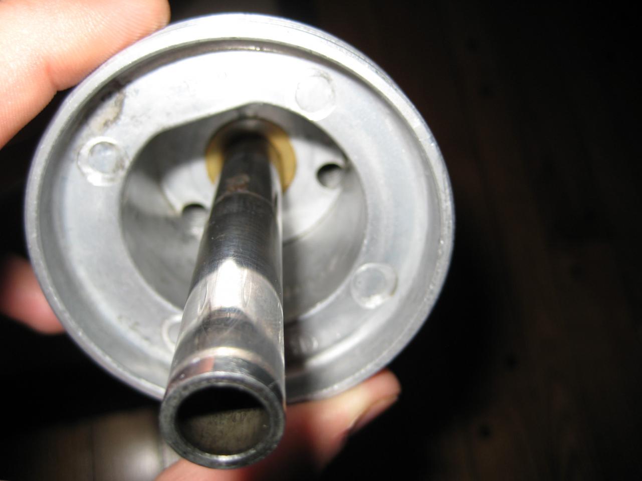

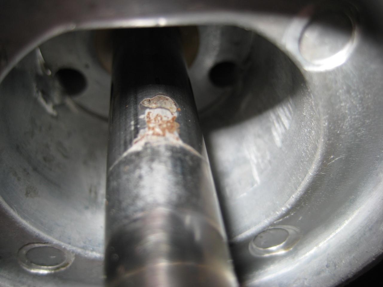

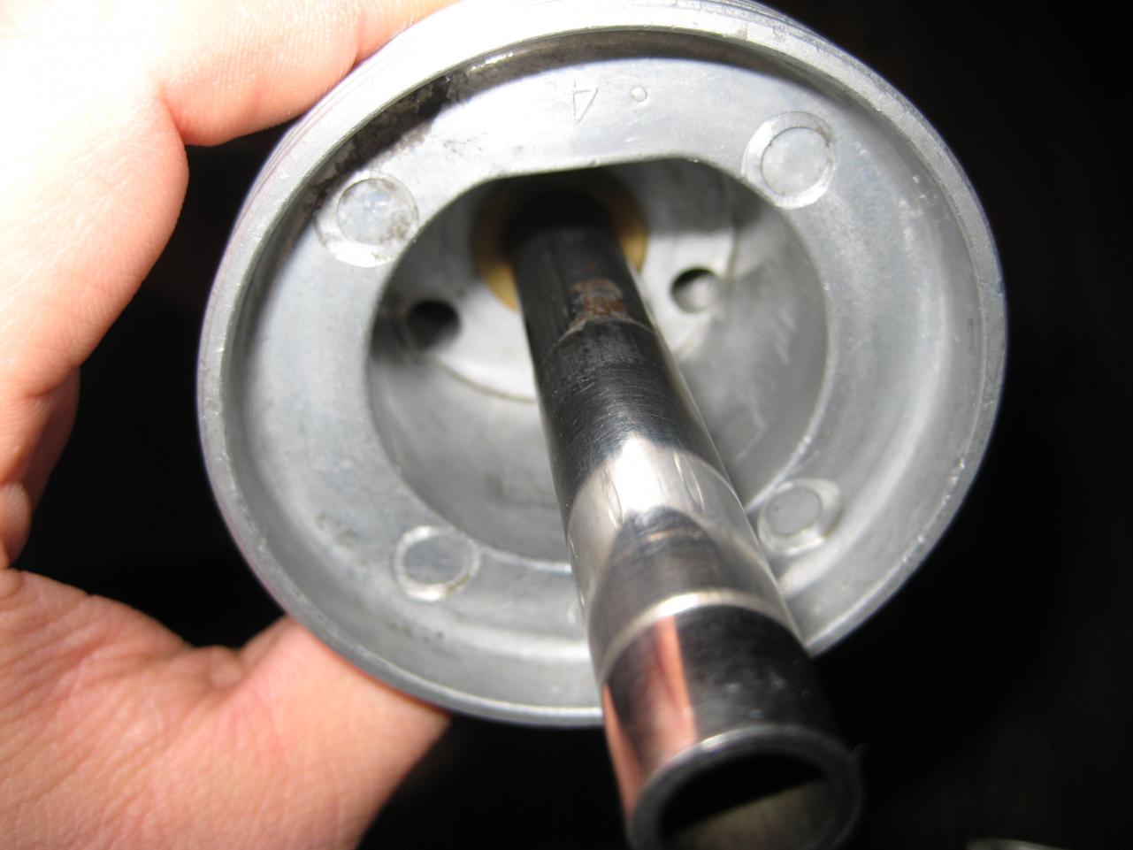

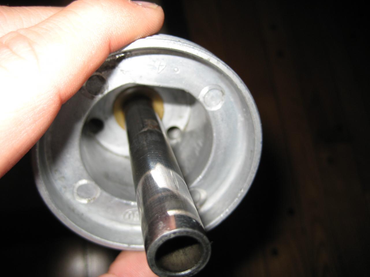

I am in the process of converting from flat tops to round tops on my 74 260Z. I bought round tops from ebay and a rebuild kit from Z Therapy. While installing the rebuild kit from Z Therapy, I conducted a drop test per the DVD. There was one piston that was sticking on the way down. This piston had the same behavior using both domes. I used 400 grit sandpaper to remove some of the aluminum per the DVD. While doing so, I noticed an imperfection in the piston. I've attached photos to help illustrate. At this point I am wonering what my options are.
1) Is there any way to repair this? Should I just keep removing material using the 400 grit sandpaper (does it even need to be repaired)?
2) Is my piston junk? If so can I replace just the piston or am I better off just buying another carb from somewhere (ebay, online, etc)?
Any adivce you can give would be greatly appreciated.

I don't think the outer part of shaft that is blemished actually contacts the dome. The tolerance is on the inner bore of that shaft with the dashpot plunger, so unless that shaft is bent, I doubt your problem is there.
