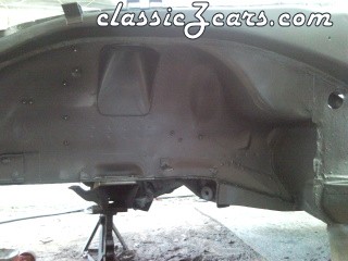

This pic is posted on Philbar73 photo album. I'm assuming this is the area he is speaking about. It appears that the problem is a common Z car issue. You will need to make weld in a metal patch and a new reinforicing plate to the area.

I believe your right GNose. I think he's talking about the little fender perches that sit on top of the upper chassis , designed to give the fender a bit of support.
Here's a pic for the people that cant get their head around what he's talking about. Notice the 3 perches on top of the upper frame "air tube" above each wheel on either side.

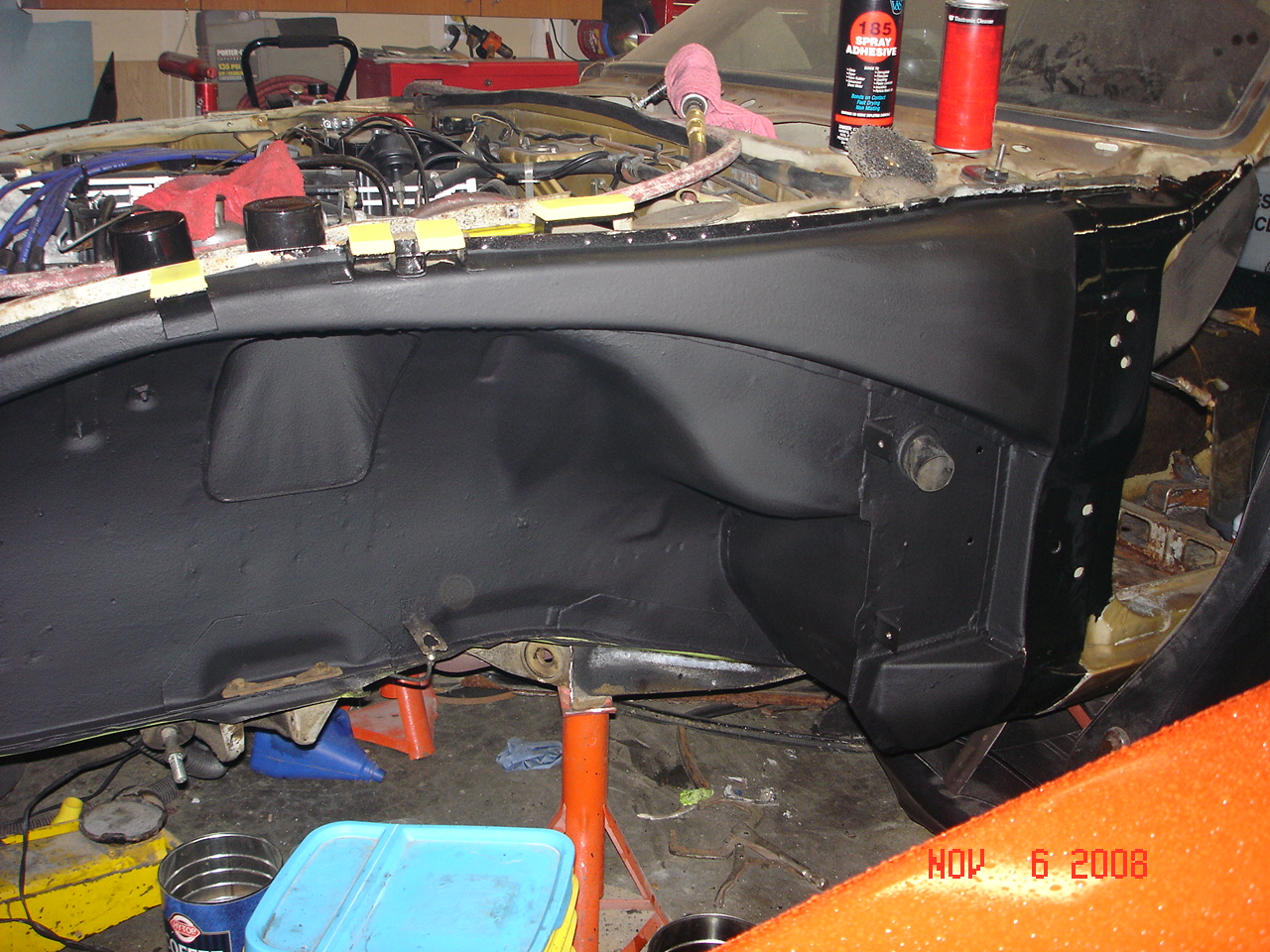

So are you looking to replace the foam?
If so, I went to the craft store and found one of those 1/2" thick foam soda can insulators, used to keep your drink cold in the summer.
It's a closed cell foam and won't retain water. Costs about $1.00, cut it into squares to sit on the perches, glue in place and instal the fender. You can see the yellow foam I used on mine in the picture below. These should also help for when you or others decide to Lean on the fender up top.
