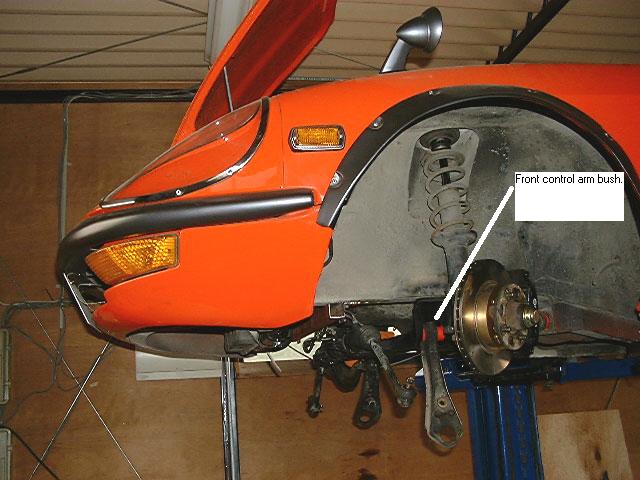

I need help as I'm a bit stuck with replacing my front control arm bushes. Ok so I've managed to get the old one out by burning it out so that's fine. The problem is the new ones I've got. The package says front lower control arm bushes. I suspect however there the rear ones.
One has a label saying front the other rear but I believe the rear control arm has two bushes on it. So I think they've given me the wrong ones. As I understand the front has only one main bush that connects to the cross member. I need the rear ones anyway so that's not a problem.
I have included a picture of what I'm trying to replace so you know what I'm doing. Picture is thanks to EricB's picture gallery.
Just replaced these bushings on my '71Z. Picture looks about right. The bushing with the thicker flange must be on the rear side of the control arm. The thinner one goes on the front side. The package should then fit snugly to the frame mount. Hard part is getting the old sleeve out and then cleaning the old rubber from the control arm ID. Good luck!
