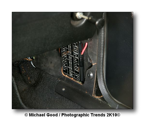

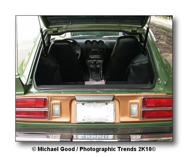

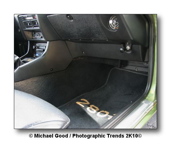

Here a few pictures from the inside of mine, the 280z's did not have diamond pattern vinyl, and the carpet was not on the shock towers. The vinyl was like the back of the seats.
As you can see there is carpet on the trany tunnel.
