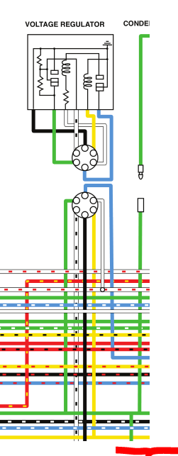

I had the same problem with the battery draining.  The atlanticz wiring diagram doesn't take the relay in to account.  The relay is supposed to get power when the engine runs, but the ZX swap scheme gives it power all the time.  I ran a wire over to the fuel pump power plug by the passenger seat to use the same power circuit as the pump, which only gets power during starting and engine running.
It's about as basic as relays get, if you did fry yours.  Any old relay should work.  The line from the alternator is the power wire that gets misdirected after the swap.  It actually comes through the VR.  Weird that the diagrams don't show it though.  This is the 1976 drawing.

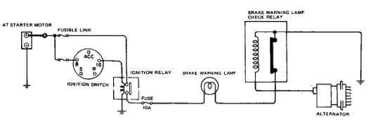

I opened the relay to verify. It appears crispy. Then with car idling and with brake light relay plugged in with the new fused 12v ignition switched source from added fuse block i pushed closed the relay contact and my brake light goes out. Let go and it comes back on.
Leads me to believe relay is bad or not actuating.
I may be wrong but I was under the understanding that the pre swap alternator source or the "N" output of the alternator drives the charge lamp and brake relay at less than 12 volts. Again I may be wrong but brake warning light relays in 76 are designed to actuate at less than full alternator output.

Could be.  N enters the VR and probably serves multiple functions.  See attached, below.  CO knows more.  @Captain Obvious  Dang, looks like he's here... posting anyway!!!
Output is in amps.  At 12 volts or higher.  Amps do the damage.  My relay has been fine on the 14+ volts my alternator puts out on the fuel pump circuit.
Good luck.  The key is to have power to the control function of the relay only when the engine is running.
N has a branch off to the relay.  It must get wired to battery voltage in the swap diagram.  Can't speak to what it's rated for, voltage-wise, or even what comes out on N.  Not my forte, and mine works.  Being lucky, I guess.

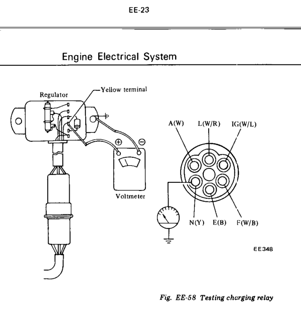

They didn't bond the neutral. The full alternator output is Line to Line in a 3-phase "Y" configuration and for normal stuff, you don't need it at all. Just run full wave rectification between all the L-L and the neutral is unnecessary for the 12V alternator output. One side of the six diodes becomes ground and the other becomes alternator output. No neutral needed.
However, they brought the neutral out to supply a couple things like the brake check relay and the voltage regulator. Not sure why they did that instead of just using the full output, but that's what they did. For some reason, they thought using Line to Neutral was a more reliable indication that the engine was running and the alternator was turning and working. Maybe it has to do with losing one phase or something?

I looked at the 76 wiring drawing to fill in details. The neutral goes to a coil in the VR in the 76. When the potential on the neutral is higher than ground, the associated contact moves the blue wire (lamp) from in contact with ground to the white wire (12VDC+) and lights the charging lamp. (Unless I have something backwards from looking at drawings when I'm tired.)
For the 74, the neutral goes to a coil in the VR and when the neutral has voltage with respect to ground, the associated contact grounds the black/yellow wire that goes to pin 12 on the Seatbelt Interlock unit.
For the 240 wiring diagrams, the VR is shown as a black box, so I don't have a ready description of what all it does in that application, though I think I have a 240Z VR lurking around unused in my garage.
Actually it "unlights" the brake warning lamp.  So the relay isn't as simple as I said previously.  It's a normally closed relay.  One of those 5 pin Bosch units, I think, would work.  Hundreds in the wrecking yards and eBay for cheap.
I remember some basic AC to DC conversion stuff, with rectifiers and wave forms getting their bottoms flipped over and all that, but learned it long ago and only 101 level and it's all corroded now, so I can't even make a guess on what N is doing here.
The relay in question sees 12 volts through the switch contacts, where the power comes through the lamp on its way to the relay, where it is grounded, and it sees N voltage through the relay coil which opens the circuit causing the lamp to go off.  The relay coils are what has crisped here.  Maybe my relay is living on borrowed time.
Is there any way to tell what voltage a relay coil is rated to?  Marks, codes, etc.  The coils look just like the EFI and fuel pump relay coils.  Which get crispy also, over time.  The brake warning relay also tends to get wet since water pools in that area when there's a leak.  There are no drain holes.
Mea culpa. I misread the wiring at the lamp. Based upon Zed Head's last post I looked again and realized my mistake. I thought the lamp had blue & black wires going to it. (That in itself confused me some because with the 260Z, blue was usually a wire that became grounded.) Instead, the lamp has blue & green wires going to it. That makes sense since green is usually a positive. I stand corrected, even though I'm sitting down right now.
