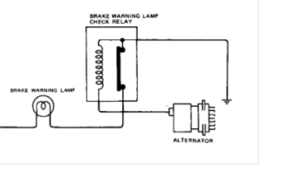

Actually it "unlights" the brake warning lamp.  So the relay isn't as simple as I said previously.  It's a normally closed relay.  One of those 5 pin Bosch units, I think, would work.  Hundreds in the wrecking yards and eBay for cheap.
I remember some basic AC to DC conversion stuff, with rectifiers and wave forms getting their bottoms flipped over and all that, but learned it long ago and only 101 level and it's all corroded now, so I can't even make a guess on what N is doing here.
The relay in question sees 12 volts through the switch contacts, where the power comes through the lamp on its way to the relay, where it is grounded, and it sees N voltage through the relay coil which opens the circuit causing the lamp to go off.  The relay coils are what has crisped here.  Maybe my relay is living on borrowed time.

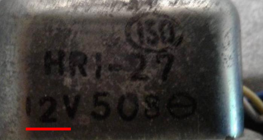

Is there any way to tell what voltage a relay coil is rated to?  Marks, codes, etc.  The coils look just like the EFI and fuel pump relay coils.  Which get crispy also, over time.  The brake warning relay also tends to get wet since water pools in that area when there's a leak.  There are no drain holes.
Only marks , numbers, I found on the relay were on the outside case. See picture below maybe someone can decifer if they state rating of relay.

Thanks for the pictures.  Looks like it's rated for 12 volts even if it's never supposed to see it.  And it just sends it to ground so nothing on the back side to drop current.
Heat, moisture, vibration, age...lot's of reasons for these old parts to fail.  You'll need the wiring diagram and the colors from the harness, I think, to figure out the circuits.  The wire colors on the components are often different than the harness.
Atlanticz has a 75 diagram but I just looked at it and it doesn't show the relay.  76 is probably your best shot.  Or just use a meter.  Two grounds, two powers, but only one power wire with the engine not running and the key on.
