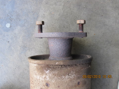

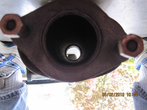

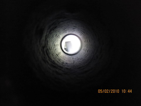

May 2, 201014 yr Author comment_318006 Just to tie this up and for anyone else that wondered, here are a few pictures. The resonator (actually an anti-resonator I believe, by definition?) does neck down a little at the inlet then back out at the outlet so does create a flow restriction. But the interior is pretty smooth. There are some holes in the interior but no "teeth" to create turbulence. For those interested in the esoteric Z stuff... (and of course, the obligatory shoe photo - Asics) Edited May 2, 201014 yr by Zed Head Link to comment https://www.classiczcars.com/forums/topic/35633-pre-muffler-mini-muffler-whats-inside/#findComment-318006 Share on other sites More sharing options...
May 2, 201014 yr comment_318029 Glasspacks have the "louvered cores."Here is an example:http://www.who-sells-it.com/cy/holley-performance-products-inc-2055/flowtech-airmass-mufflers-9339/page-1-fullsize.html Link to comment https://www.classiczcars.com/forums/topic/35633-pre-muffler-mini-muffler-whats-inside/#findComment-318029 Share on other sites More sharing options...
