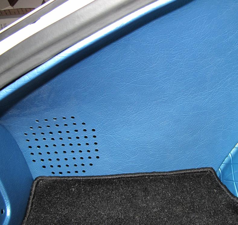

I did the right side last night. Using some tin snips I was able to take off small amounts at a time until the fit was correct. I still had a few issues with one panel, but you can barely see the mistake I made........:stupid:
It seems the fitment is way off only on the rear and two speaker panels, the smaller panels appear to line up better. Hopefully I will be done today and can post some pictures.

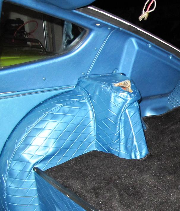

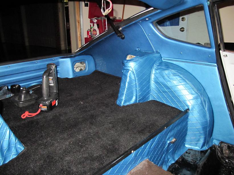

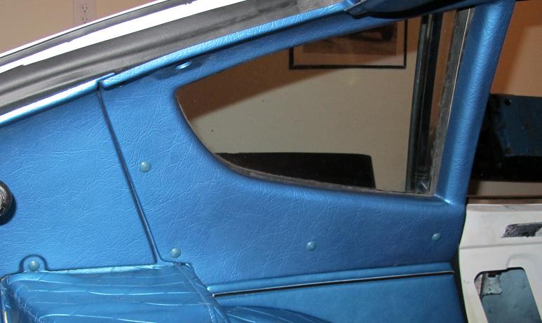

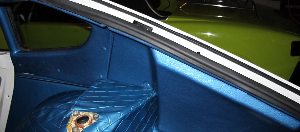

I thought about that, but the old panels were so brittle I couldn't really get a good tracing. Also a few were cracked at the edges and I was afraid I would be off too much.
The trimming is a pain in the butt, but it worked out fine. Just took forever because you have to do small amounts then trial fit and then repeat 4,000 times more..........:tapemouth
But in the end it worked out fine. Here's a few pictures.
PS....The doglegs actually match perfectly, but for some reason look lighter in the pictures. Nothing is in permantly, just basically psedo fitted.
