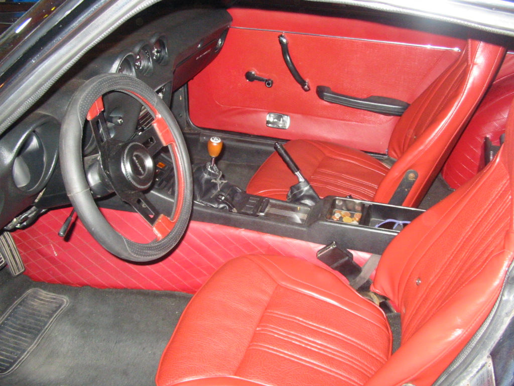

Assuming that you'll go with store bought replacements, you'd probably be looking at $1000+ for mostly everything except the door panels, which are harder to find. Yet, that's Black Dragon Prices and they aren't the cheapest(Pg. 28, 65, 68 and 71 of their on-line catalog), but I don't know what other options are local for you, so check. Here in Cali there's Motorsport Auto, which is a bit cheaper and you'd have to pay for shipping anyways from either. Just not quite as an extensive catalog there. I definitely recommend searching some used part outs, though. That'll save you tons of money. Personally, I love the red :)

Did you get the car? It looks like it might have a dash cap?? There are replacement door skins that you can purchase and do yourself or have them redone by professionals. Everything from the plastic panels in the back, to the vinyl, to the seat foam/covers, carpet, you name it. I agree that I would leave it stock initially until you get a good feel for the car (unless the engine is shot and needs replacing). This also gives you the chance to use the car and give you more money in pocket to fix it up! No offense to you, but a big concern around here is when there are young kids posting about wanting to swap engines and go racing in the street. We have seen too many people wrap their cars around a pole and not only kill themselves but innocent people as well. I thinks its awesome someone your age loves z cars. They are a timeless classic. The great thing is that the engine bay is large enough to give you a wide selection of engines and modifications. There may be a lot of things you will want/need to change before the engine. I didn't see if there was a lot of stuff already done to the car but besides the interior, you may also change the bushings, exhaust, springs/shocks, need to take care of numerous rattles etc. Let us know what happens.

How much would it cost to redo the interior, from red to black
I have seen a 240 red interior that was resprayed with good quality black vinyl spray from rattle cans 12 years ago and still looks great. With some masking and care it can be done for very little cost.;)

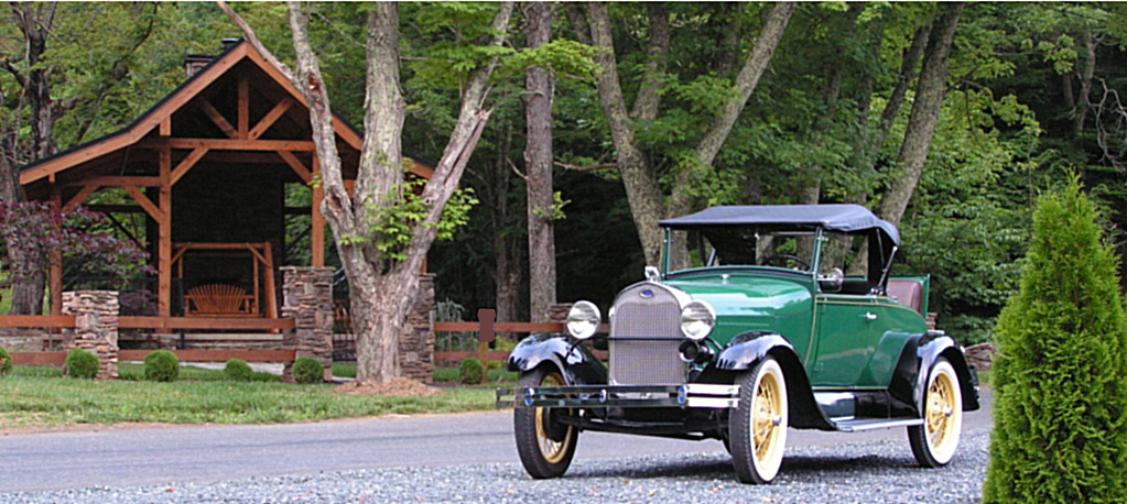

Last month I used a SEM spray dye (black) for my 1929 Ford Model A Roadster. It was fantastic! If you do this be sure to use the SEM vinyl cleaner and don't skip or shortchange this step. I laid down 4 thin coats and then one solid one. The seat that I restored turned out fantastic - it did not alter any of the grain - once cured, I can not scrape or flake the finish off - I was and still am really impressed with the product. I have showed several people and they can not believe the seat was sprayed with a canned dye.
I'll be showing this car this weekend in a local car show!
