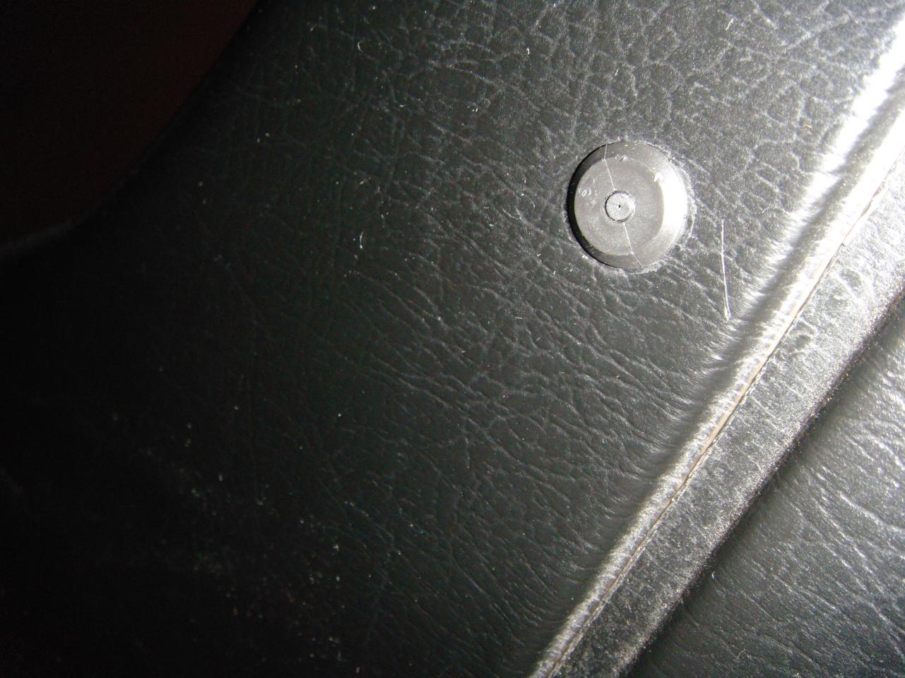

Sounds a lot better than the option the PO chose on my car.
He used some fastener which looks like that, but has a plastic screw, the head of which is designed to shear off when it's in tight... that or he CUT them off once he had them screwed in. They are flush, and impossible to push the center in.
I bought the genuine article Nissan clips for whenever I need to pull a panel, but it is an absolute nightmare to get the old ones out.
Anyone encountered those types of clips, and have a good way to remove them? I'm trying to avoid mangling the panel, or the body mounted hole through which the clip goes on the backside.
It's been 6 years or so since I had to remove any of them, but I seem to remember they worked a lot like drywall anchors - the type that splay outward when the screw pulls the far end inward.

I'd consider a small drill bit at slow speed straight through the center of the broken plastic screw. You could then go with a bigger bit as needed. Sooner or later you'll remove enough plastic that the part of the clip that expands behind the panel won't stay expanded. Another option is to use some pliers like this to simply cut the entire head off of the fastener provided there's enough wiggle room to get the pliers under the head.
