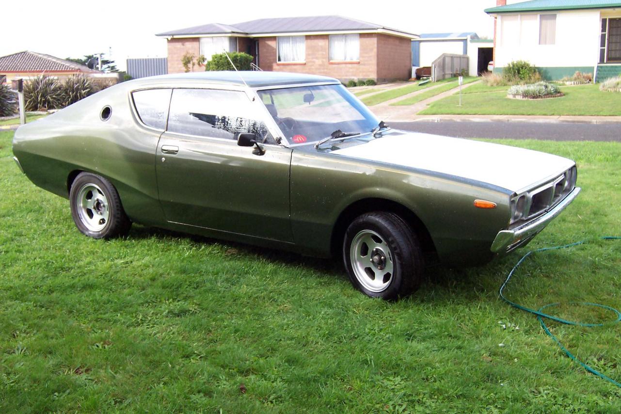

Congratulations mate, i cant even think how much excitement you must feel knowing its so close!
Thanks, It's taken awhile to get to this stage,
Cant wait to get it registered and move my running gear from my other 4 door,
Turboed L24, Megasquit II, EDIS, 3 inch exhaust..

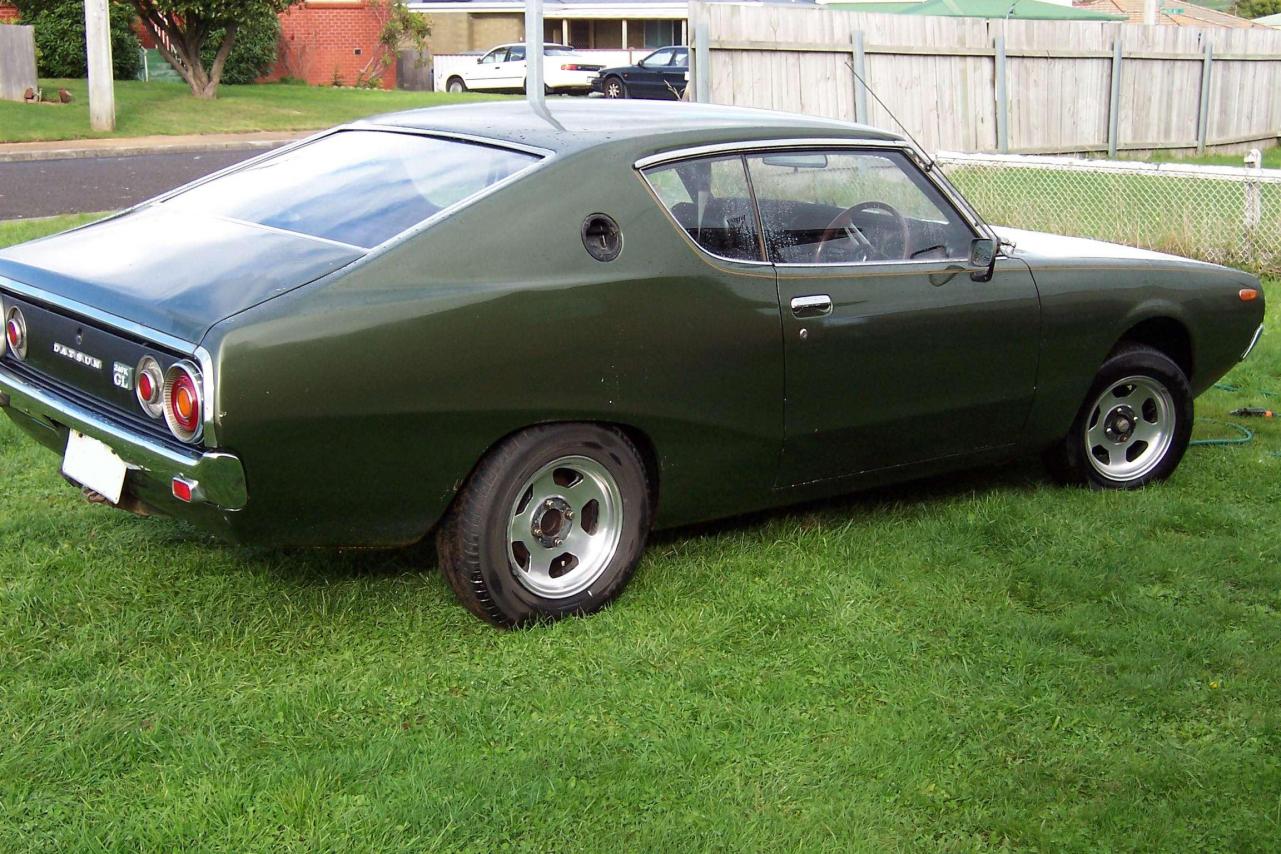

took it down to get inspected today, passed first time
get rego on it tomorrow,
drive around tomorrow night..
I'm very happy, but I may have a dud rear wheel bearing, theirs a noise, need to track it down
