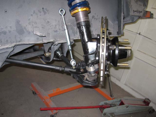

I have this big brake set up on one of my race cars. This is the first time I have tried this before on a race car. Here is my problem. Something up there is flexing enough to cause the pedal to be very long in between using the brakes. As Long as I am going straight, the issue doesn't come up, great pedal. If I swerve as to warm up the tires, pedal to the floor. Everything up there is tight.
Anyone run into this before? Someone told me they have heard of this and spindle is flexing. Wow!

Pad knockback. There's enough flex in the hub and/or caliper mounting that the pads are pushed back into the caliper bores with any kind of lateral load. Common problem on 350Zs. Stoptech and others sell some light springs that go behind the caliper piston that keep the pads in slight contact with the rotors.

I followed panchovisa's example and put a gusset between the strut and the flat spot behind the spindle, you could do something similar to what I've done.
I'd be looking other places first to solve the problem with the pedal though. Pad knockback on a Z is not something you hear about very often, even with the fast autox guys who would presumably be totally screwed at the end of a slalom if this were a common issue. The caliper mount is integral to the spindle in the front and back, so it's not as though flex between the spindle and strut affects the relationship between the caliper and rotor.
There could be some flex in the caliper mount, seen that on Hybrid Z in this thread: http://forums.hybridz.org/index.php?/topic/70436-wilwood-caliper-damage-pics/ That thread wasn't complaining about knockback though, the problem was found incidentally.

Could be axle flex, machine spacers to fit between the inner and outer bearings. That has to be done accurately of course because then bearing adjustment will no longer be available by adjusting the nut. Which has to be done up tight to lock the spacer against both bearings.

FWIW I have the same brakes and no knock back that I can tell, if present it's negligible. I do have it gusseted similar to Jon's. I did not have the issue with my non-gusseted 280 struts either (now using 240's). With that said I have to wonder if this matters as the gusset is there for strut flexing and the entire forging, including caliper mounts, would therefore move together.

Generally the cause of knockback is hub flexing. Check the hub, bearings, races, and spindles. Check the spindles for cracks. Swap out the hubs after crack checking the replacements. Aftermarket brakes that move the caliper farther out from the hub via adapter brackets exacerbate knockback.
