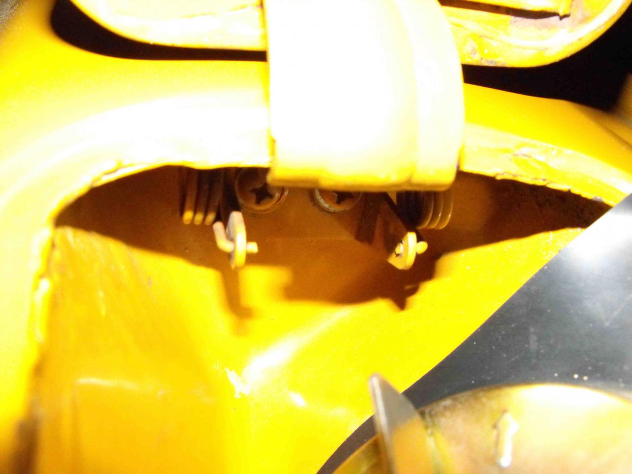

May 12, 201014 yr comment_319337 HLS30-2614 has 2 springs on the fuel door. One above the metal arc and one below...looks like 3 coils each Link to comment https://www.classiczcars.com/forums/topic/35868-early-series-1-fuel-door-question/#findComment-319337 Share on other sites More sharing options...

May 13, 201014 yr Author comment_319552 They must be fragile because #110 is missing both of them, the holes are there though.Bonzi Lon I inspected the 72 door last night. That has 1 spring with 2 coils in it. Pretty sure it would have been the same on Series 1 cars based on the layout of the holes and the indent in the hinge. Just to clarify that there is only 1 spring.... Motorman, That is the same spring I have on my 72 fuel door. The coiled sections actually are connected behind a plate that is spot welded to the hinge. It is hard to tell but it is only 1 spring assembly. Edited May 13, 201014 yr by JohnnyO Link to comment https://www.classiczcars.com/forums/topic/35868-early-series-1-fuel-door-question/#findComment-319552 Share on other sites More sharing options...
May 13, 201014 yr comment_319557 The coiled sections actually are connected behind a plate that is spot welded to the hinge. It is hard to tell but it is only 1 spring assembly. I wasn't aware of that. It's very hard to see in there. All I could really see were the two coils. Did not realize they were connected. Link to comment https://www.classiczcars.com/forums/topic/35868-early-series-1-fuel-door-question/#findComment-319557 Share on other sites More sharing options...
