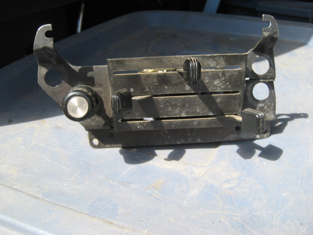

Surprise! Fits the console opening, does not fit the 72 control levers plate.
I have my old control levers from my 73 after going Vintage air and replacing all that nonsense. Let me know if you want them. I think the four cables it actuates are all the same.

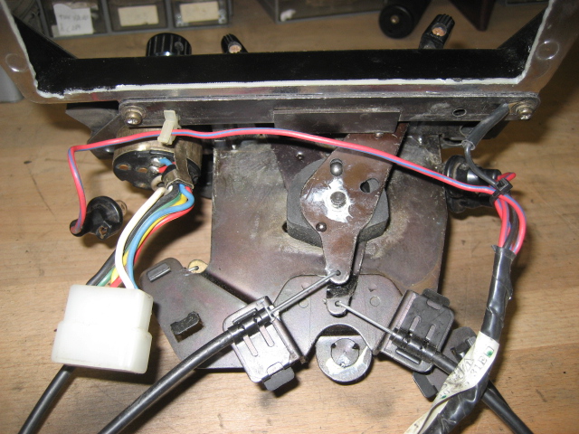

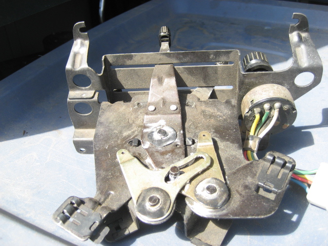

Here is the one picture I have from the AC install that kinda shows the 73 controls on the back of the faceplace and how it mounts. Hope it helps.
The dash opening is identical. Nothing to modify there.
I can take more pics of the parts when I get home. Drop me a note to z240@shaw.ca
Jim
The HCP from the 73 including the cable mounting assembly COMPLETE will fit into a 72 dash. The only problem you might run into is that the 73 HCP is just slightly wider and thicker than the 72, which might cause a bit of difficulty on re-assembly of the dash and center console. It IS do-able though.
The 73 HCP and lever assembly replaces BOTH the Plastic Panel AND the cable levers from 72. You can't intermarry the pieces as you have discovered.
What it seems you are trying to do is to use the 72 lever assy with the 73 faceplate. From your pictures you are also missing the shrouds for the light bulbs and the clear plastic - light conducting bit that sends the light to the spaces above the levers.

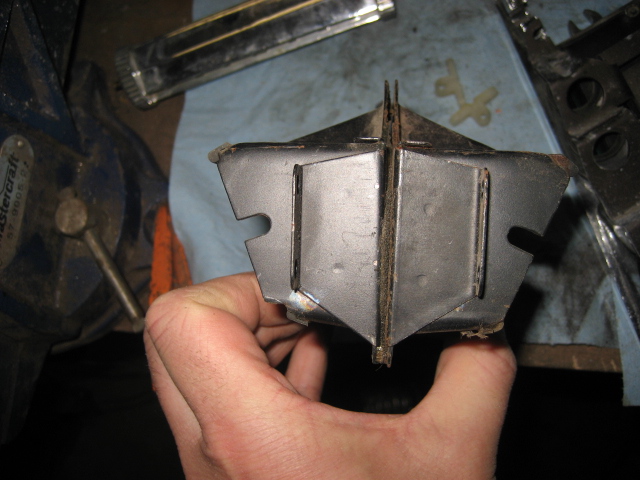

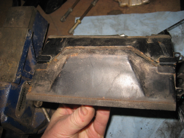

I took the duct piece from a 73 and 72 HCP and held them together. I don't see the difference. Pics attached. They mount the same way, have the same chrome duct, same exact shape that I can tell.
Jim
Good Morning Jim
The metal duct adapter from the 72 HCP must have a slightly larger (deeper) flange than the 72 because it wont fit with having to cut the center plastic insert panel (lever slot panel) - I will take a pic when I get home tonite and show you what is happening.
