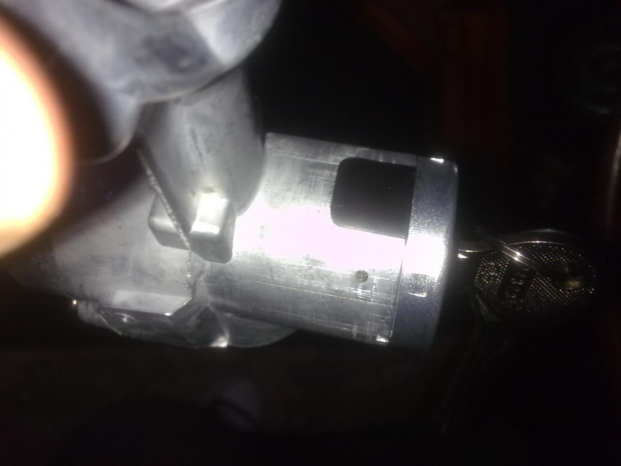

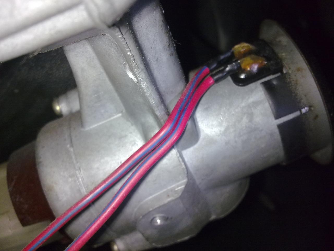

Posted May 15, 201014 yr comment_319791 Am i in trouble? I bought new ignition switch and it has some difference between original. What are those 2 wires? Link to comment https://www.classiczcars.com/forums/topic/35913-ignition-switch-difference-help/ Share on other sites More sharing options...
May 15, 201014 yr comment_319794 Those are for the 'key in' buzzer. Link to comment https://www.classiczcars.com/forums/topic/35913-ignition-switch-difference-help/#findComment-319794 Share on other sites More sharing options...
May 15, 201014 yr Author comment_319803 Alright, so not important. The buzzer is not working so it wont do any difference. Thanks! No i gotta find some tool to remove those "anti-theft" screws. Link to comment https://www.classiczcars.com/forums/topic/35913-ignition-switch-difference-help/#findComment-319803 Share on other sites More sharing options...

May 18, 201014 yr Author comment_320119 New ignition switch on place and working! I hammered the old screws off with flathead screwdriver, luckily they were not tight. In new one, "anti-theft" screws have 5.5mm bolt heads wich can be snapped off easily. I wont snap them in case i need to remove that switch again. Nice to have reliable switch Link to comment https://www.classiczcars.com/forums/topic/35913-ignition-switch-difference-help/#findComment-320119 Share on other sites More sharing options...
