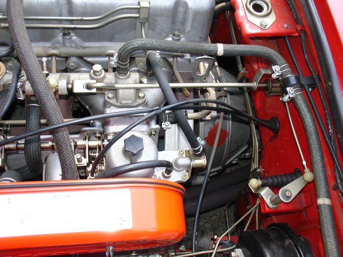

1. Adjust the Tension Rod on the engine side of the firewall between the bell crank and Torsion Shaft to 7-3/16"
2. Adjust the interior Tension Rod between the throttle and bell crank to 4-1/4"

The 240Z throttle linkage is rather bad this way even under the best of conditions. Adjusting the rods may help some, but the real answer is to modify the bell-crank to try to eliminate the over-center action of the linkage.

Well, I just got in from the garage. I disassembled, cleaned and lubed all of the parts in the throttle linkage. The Tension Rod on the engine side of the firewall between the bell crank and Torsion Shaft was right on spec at 7-3/16". The interior Tension Rod between the throttle and bell crank was long, at 4-7/16 as measured center-to-center of the end caps. I removed the end to install a new throttle boot and reinstalled the end, setting to the FSM spec of 4-1/4".

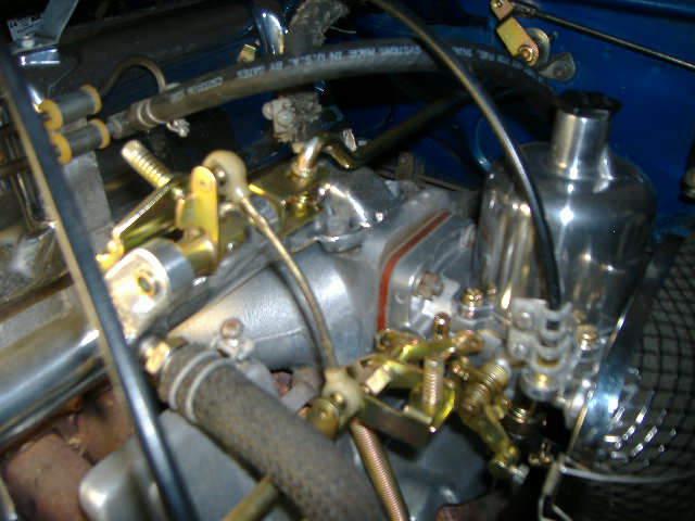

I also have been experiencing this, but only after I changed out carbs, balance tube and linkages. I was able to get a little more slack by bending the rod like I had seen on another Z car years ago. The carb spacers are only 5mm thick because the N36 manifolds have 30mm studs. Other spacers are 15mm and 40mm on the studs.
So far it is working much better than before, like 90% better, still could use some tweeking on the bell crank.

One thing to add about the process of changing the angle between the two arms on the throttle pivot. All threads so far discuss cutting the top arm off then re-welding it at the new angle. That's messy
For the early gen pivot arm type such as Arne's, there is a far simpler technique. Cut right through the tube part about half way up.
Place a drill bit that just fits in the hole to re-assemble the two halves to align them, rotate the top and bottom halves to the new angle (~45 deg verses the original 90ish). Weld and grind until the tube is back to being a seamless tube. The drill bit will keep them aligned so it will slip over the pivot pin on the firewall again. No one will even know you touched it if you do a pretty grinding job.
