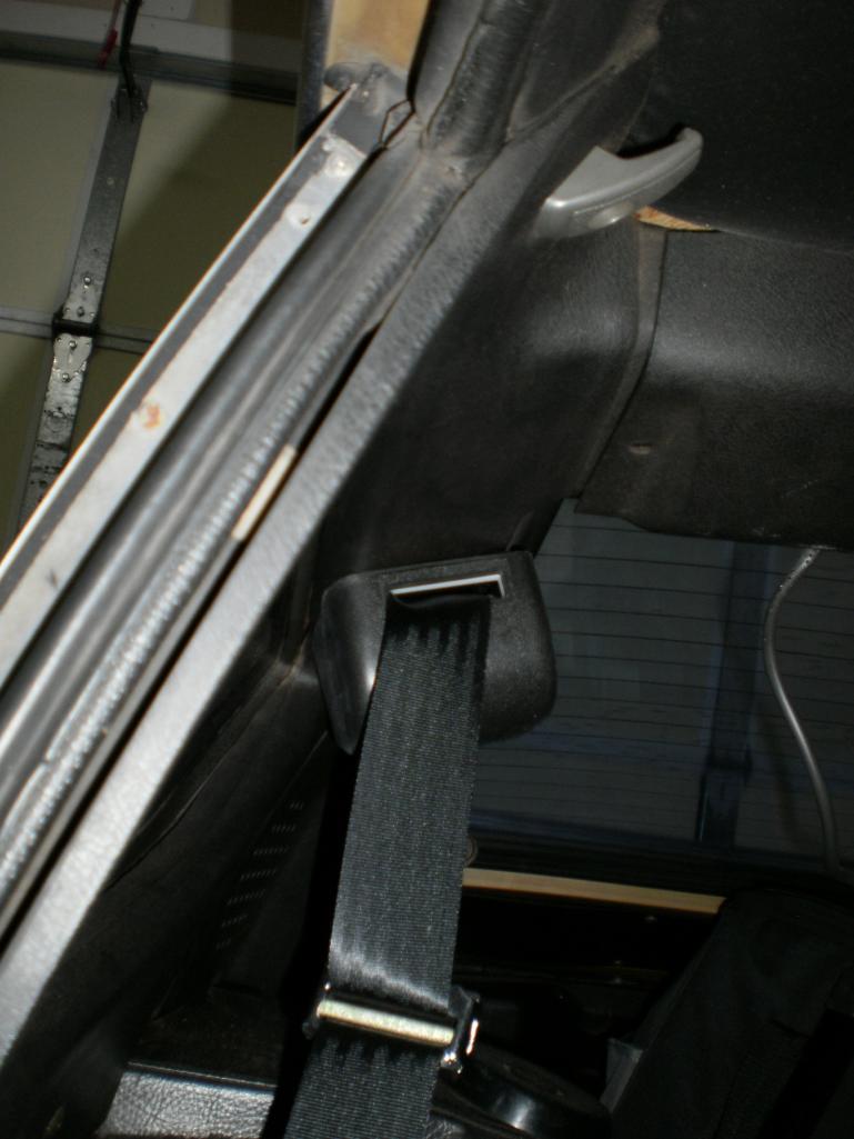

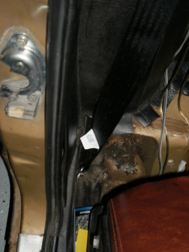

SteveJ Posted June 12, 2010 Share #16 Posted June 12, 2010 Steve,I read your link several months ago when I was bound and determined to replace my fixed 3-point harness. I appreciate the fact that you didn't want to post photos (I often feel the same when folk ask for pics on really obvious mods/improvements/repairs). However, having typed that I saw the measurement listed on the WESCO site for the roadster belt retractor unit and it's *huge* compared to the mounting point. I mocked up a 4x4x3 wooden block to see how it would mount, and in every case it wouldn't clear my trim plastic. Anyway, if it all possible, you think you could snap a pic or two to show how the mounting looks on your car? R/ Dustin Here you go, Dustin. I didn't take pictures of the inboard side, but I did use WESCO's hardware that included a mounting bracket bent at a 90 degree angle. I haven't had any clearance problems. Steve Link to comment Share on other sites More sharing options...

konish Posted June 13, 2010 Share #19 Posted June 13, 2010 Steve,Awesome, thank you very much. During my mock-up, I didn't think to hang the box off into the hatch area...duh. I think I'll go ahead with this as soon as I'm done moving (relocating to Okinawa from Yokosuka). My 3-points are old and I consider them a liability as cinching them up tight enough to protect does not allow me to lean forward enough to look into traffic or reach anything else inside the cabin which makes me have to unbuckle them at the most inopportune times. Also, they slip over time and are generally a PIA. Thanks again!R/Dustin Link to comment Share on other sites More sharing options...
SteveJ Posted June 13, 2010 Share #20 Posted June 13, 2010 The retractor portion should go up above. The point at the buckle will act as a constriction, so if you mounted the retractor low, you wouldn't be able to lean forward. Link to comment Share on other sites More sharing options...
