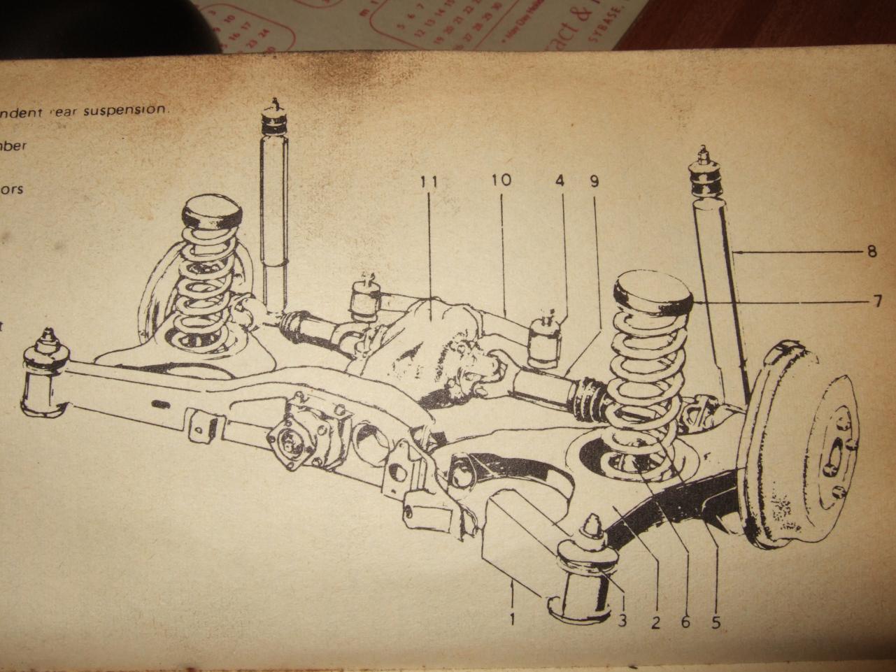

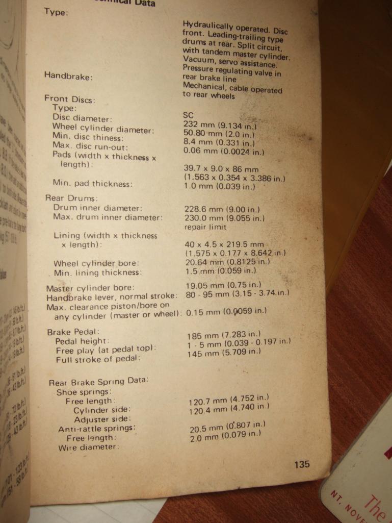

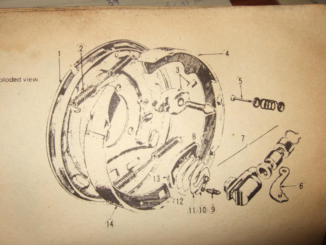

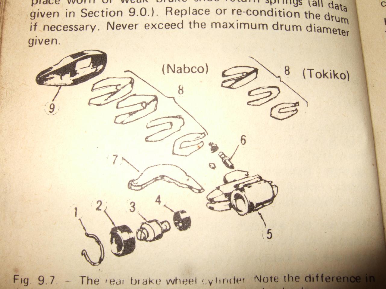

June 2, 201014 yr comment_321345 Best I could do. Link to comment https://www.classiczcars.com/forums/topic/36057-datsun-710-sss-rear-suspensionbrakes/#findComment-321345 Share on other sites More sharing options...
June 2, 201014 yr Author comment_321357 Thank you so much. Yes this does look like what I have. Believe I can find the wheel cylinders but the manual brake adjuster assembly seems to be a differewnt story. Anyway I most assuredly appreciate your great help with the illustratiions.Lynn Link to comment https://www.classiczcars.com/forums/topic/36057-datsun-710-sss-rear-suspensionbrakes/#findComment-321357 Share on other sites More sharing options...
