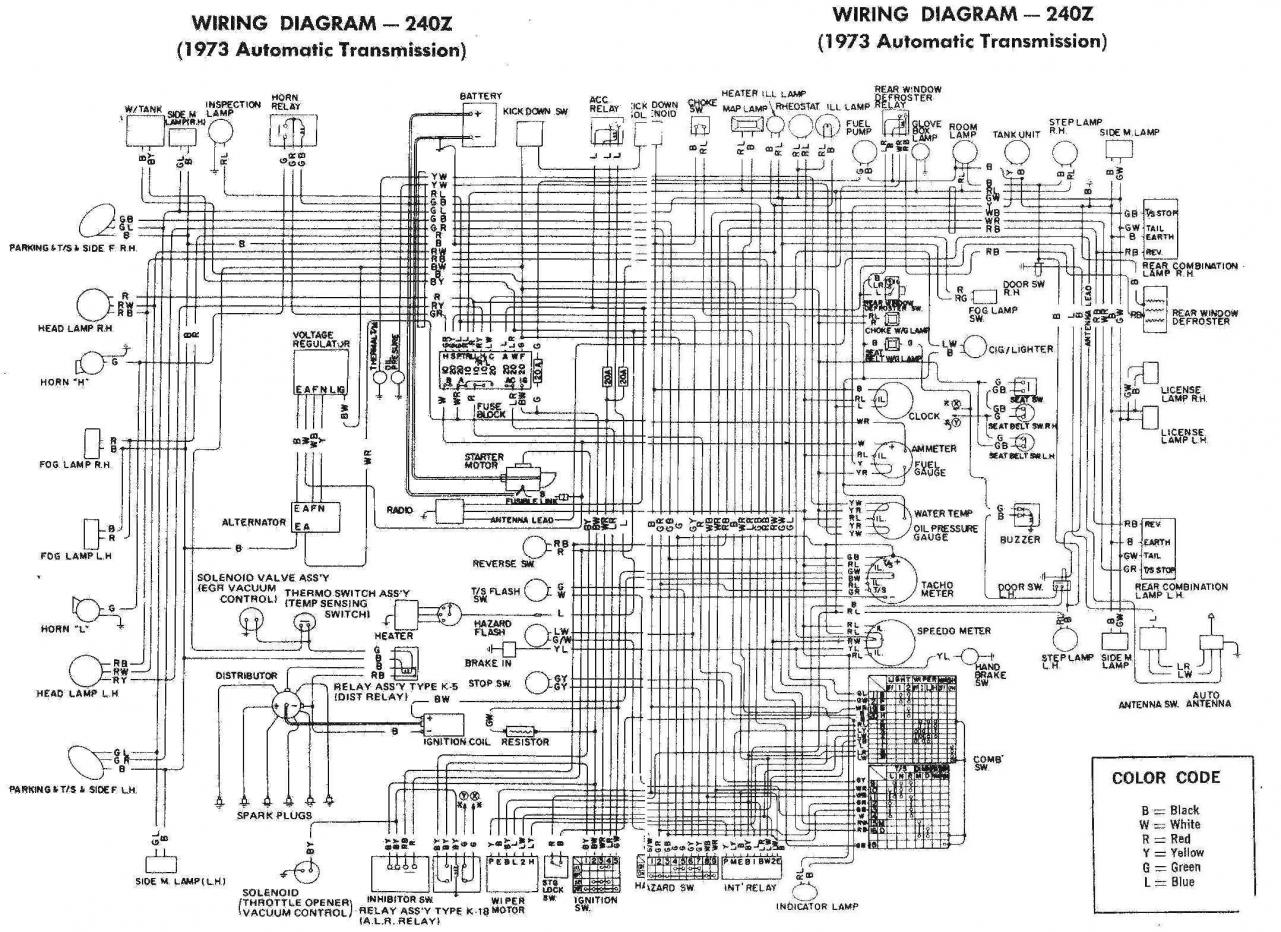

June 3, 201014 yr Author comment_321432 Maybe somebody can study the following pictures and my comments and help me out. Somebody on this site should be able to tell me which direction to go or how to troubleshoot further. I'm at the end of my rope here. I think I'm missing a part but not sure. The biggest issue is not getting 12V to the starter solenoid when the key is in START. And I think inhibitor switch and neutral safety switch are probably the same part/terms.......who knows. I'm scratching my head. What's the next step? Thanks Link to comment https://www.classiczcars.com/forums/topic/36059-372-240z-automatic-transmission-what-part-hooks-to-this-connector/#findComment-321432 Share on other sites More sharing options...
June 3, 201014 yr comment_321501 You're using the wiring diagram for a 71-72 AT, you need the one for the 73 AT. That one will show you the Green wires and their relationship to the Seat Belt Interlock portion of the switch. The one you're looking at does not, that's why you're having the difficulty in tracing the circuit.The 73 AT diagram shows the Type K-18 Inhibitor Switch which ties in the Seat Belt interlock circuit. The Manual transmission uses a different type Inhibitor Switch (K-24 IIRC). The important point being that it MUST show the seat belt and seat sensors.Other than that, your notes seem to be on target.FWIWE Link to comment https://www.classiczcars.com/forums/topic/36059-372-240z-automatic-transmission-what-part-hooks-to-this-connector/#findComment-321501 Share on other sites More sharing options...
June 4, 201014 yr Author comment_321536 Thank you for pointing me to the 73 schematic. I'll see if I can dig one up. Link to comment https://www.classiczcars.com/forums/topic/36059-372-240z-automatic-transmission-what-part-hooks-to-this-connector/#findComment-321536 Share on other sites More sharing options...
June 4, 201014 yr comment_321576 This is the one you want. E Link to comment https://www.classiczcars.com/forums/topic/36059-372-240z-automatic-transmission-what-part-hooks-to-this-connector/#findComment-321576 Share on other sites More sharing options...
