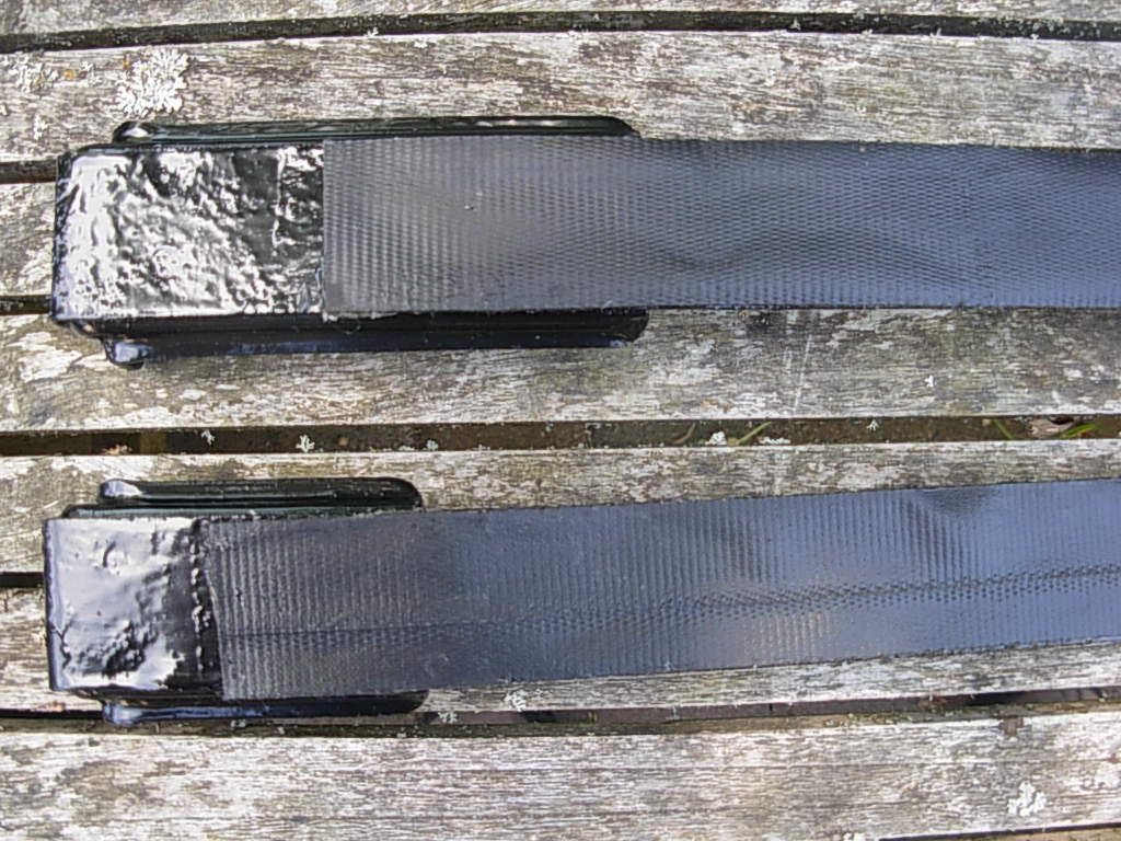

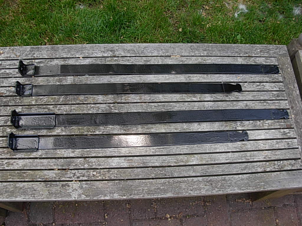

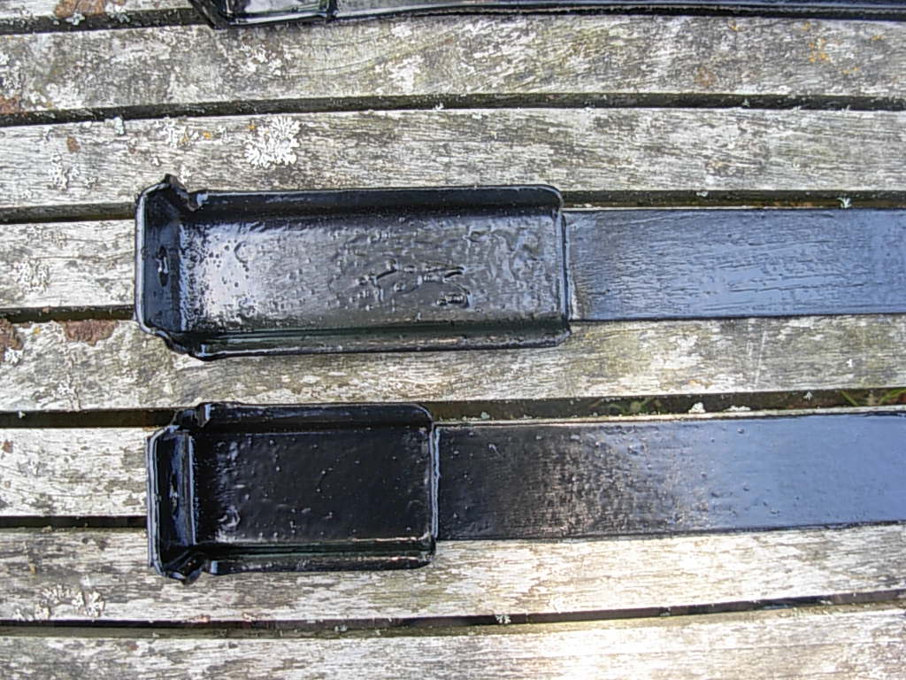

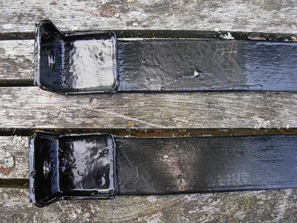

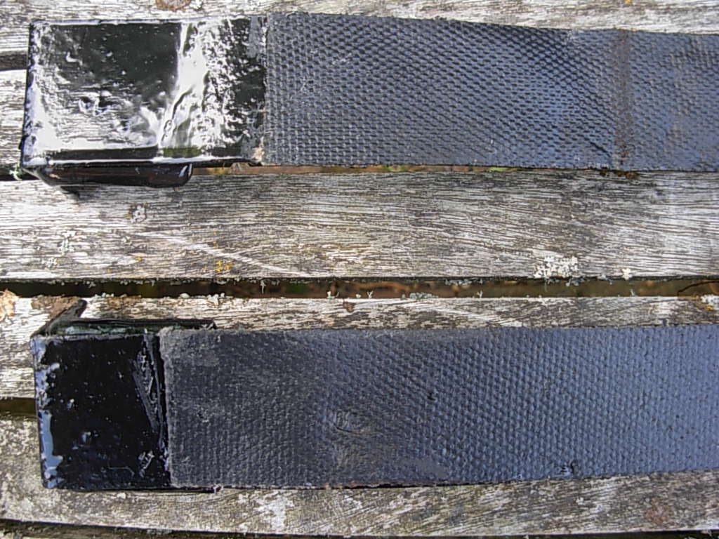

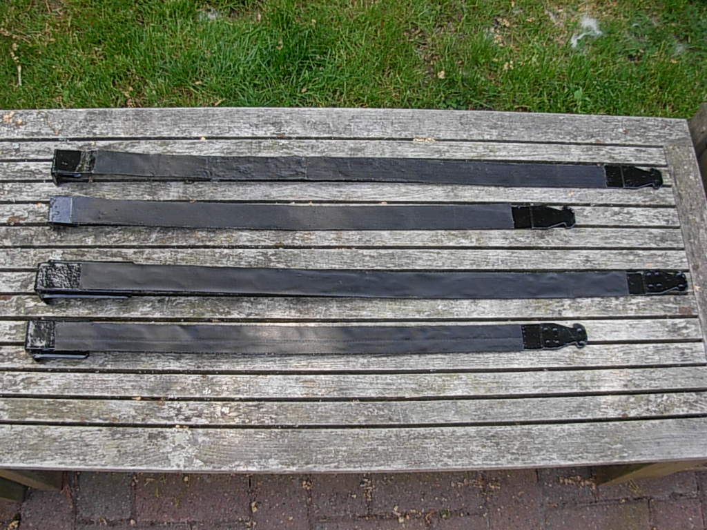

Here are some that I did last summer when I restored two gas tanks. I used POR15 and was able to reuse the original strap backing material after I cleaned and degreased it, then painted it with SEM trim black. I think I used "automotive goop" to adhere the material back to the straps. Note that there was a slight difference in the earliest straps and backing material from later ones. The set at the top is from a 11/69 production car and the set on the bottom is from a 5/72.
-Mike
