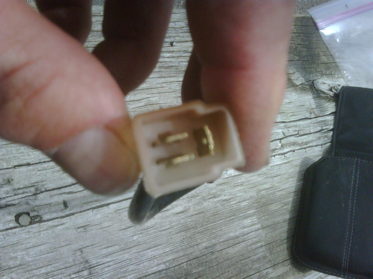

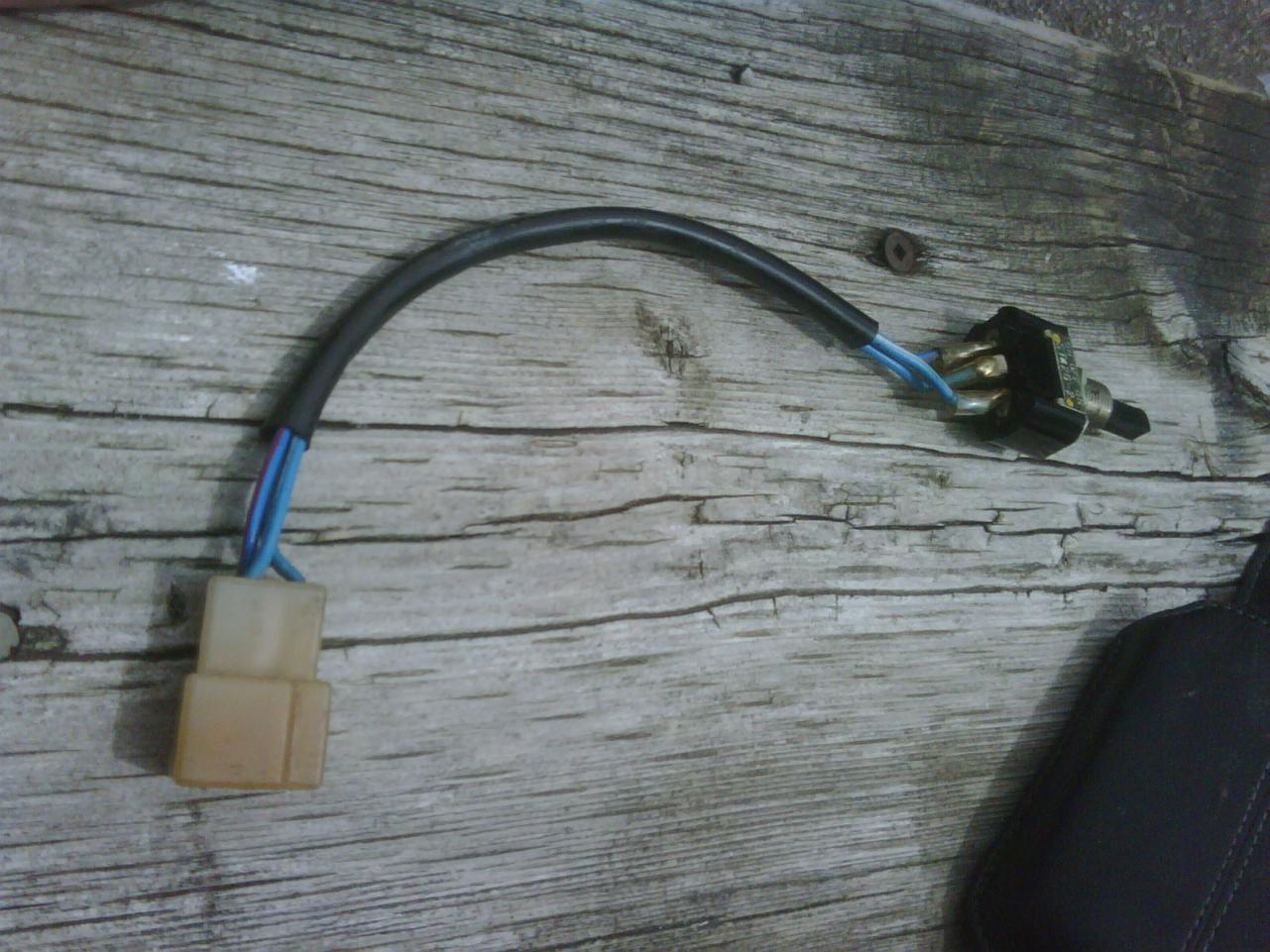

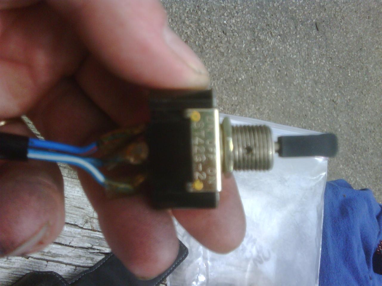

Posted June 7, 201014 yr comment_321783 Gentlemen - 1972 Z switch for ??? I wonder if you can help me with this. Attached are some pictures of a switch that was installed on the console just above the ash tray. Judging by the hole was drilled (rough) it was installed as an after thought. Since I have had the car I could never see what it operated. This switch is not a 2 position item - it springs back to the center position that you see in the picture. The switch knob can move both directions (left and right) I seem to think the center position is OFF The switch connectors look like factory original parts. All my lights seem to work ok so I have no idea what it was intended to operate. Any thoughts regards Dave Link to comment https://www.classiczcars.com/forums/topic/36100-unknown-switch/ Share on other sites More sharing options...

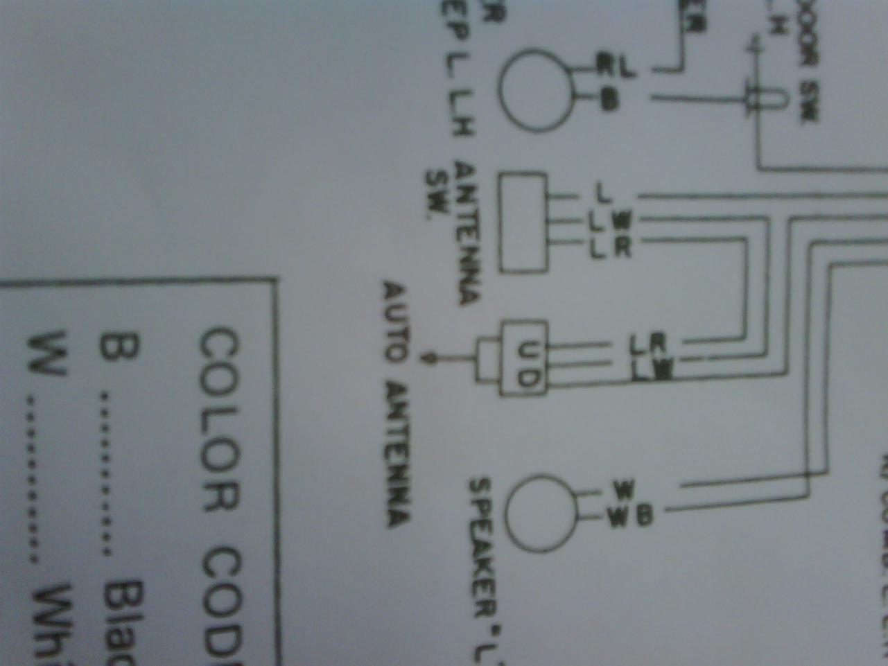

June 7, 201014 yr Author comment_321785 the wire colors are BLUE (L), BLUE/WHITE (LW) AND BLUE /RED (LR)and the only item I could find on the line diagram with those colors is ANTENNA SW.Dave Link to comment https://www.classiczcars.com/forums/topic/36100-unknown-switch/#findComment-321785 Share on other sites More sharing options...
June 7, 201014 yr comment_321786 You pegged it. That is the factory power antenna switch for a '73-73 240Z with the AM/FM radio. Link to comment https://www.classiczcars.com/forums/topic/36100-unknown-switch/#findComment-321786 Share on other sites More sharing options...
June 7, 201014 yr comment_321787 It is the antenna switch. It was common practice back in the day when replacing the original radio with an aftermarket unit, to relocate the antenna switch and the side of the console was a popular place to put it. Link to comment https://www.classiczcars.com/forums/topic/36100-unknown-switch/#findComment-321787 Share on other sites More sharing options...
