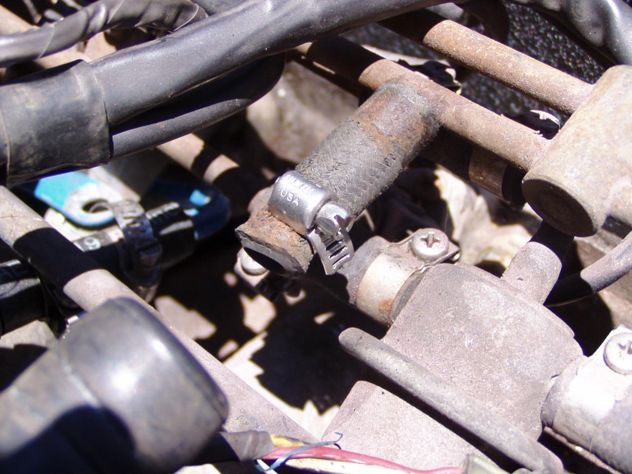

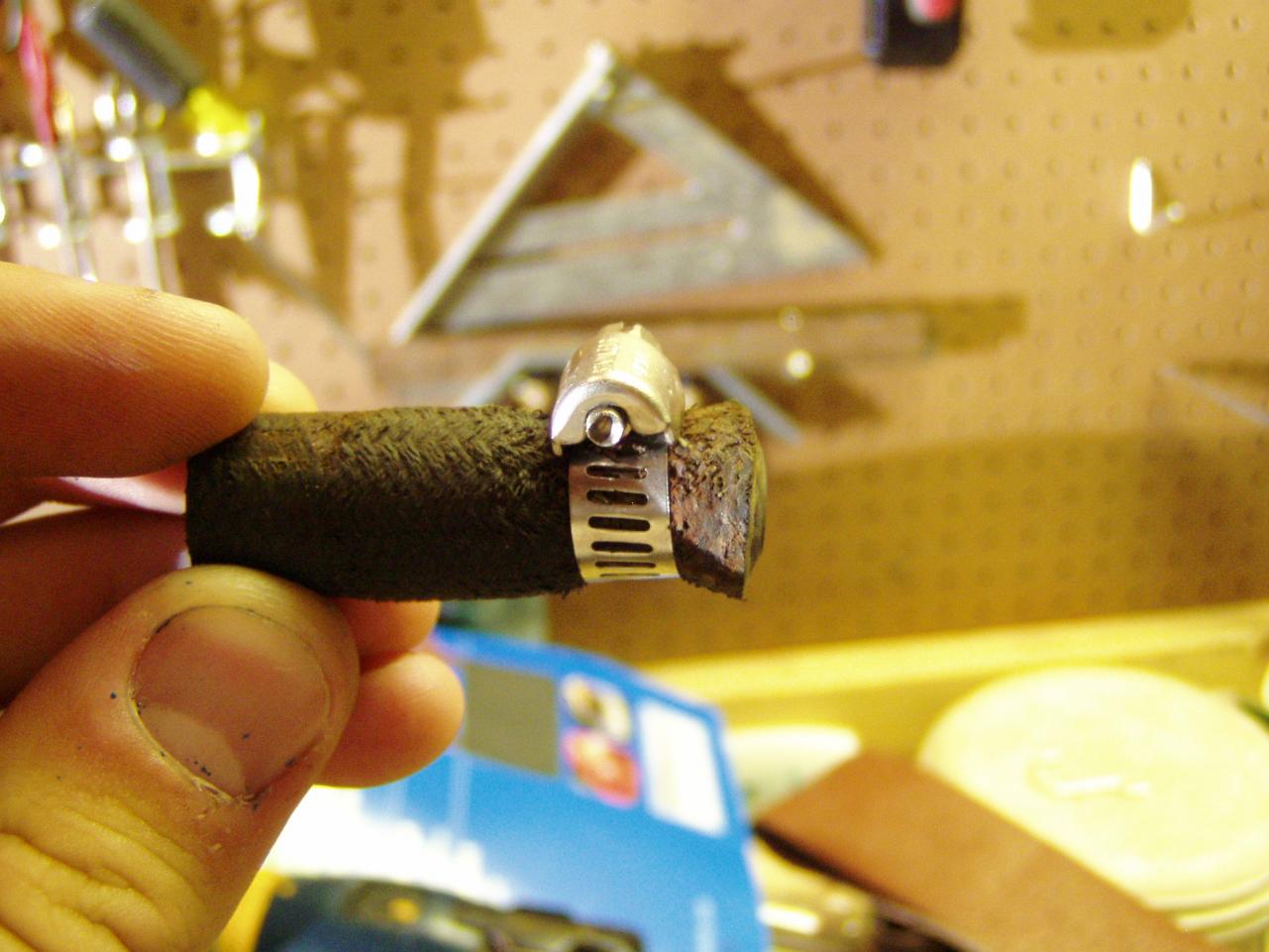

After plugging off my Cold start my car no longer does what your cars does. My car use to also have a dip in the rpms when I started it. I assume the cold start was flooding it until the ecu corrects it (or something along those lines) If I were you I'd plug it off and see if anything changes. Idk if there's a test for a leaky cold start injector.
Put a bolt where the fuel rail splits off for the cold start valve and tightened it down. I'll take a picture tomorrow if you don't get what I mean. It doesn't leek and seemed to fix most problems.
I don't mean to beat a dead horse over this cold start issue, but I just want to make sure I'm doing this right. Z Tyler Z is this what you did to plug your cold start (or can anyone tell me if this is the improper method? If so which is the correct one?)

Did you just tighten that down or did you stick a bolt in there then tighten it down I can't tell by the pictures. I attached a picture of what I did (been meaning too for a couple days now my bad).
