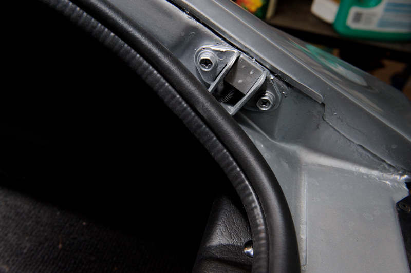

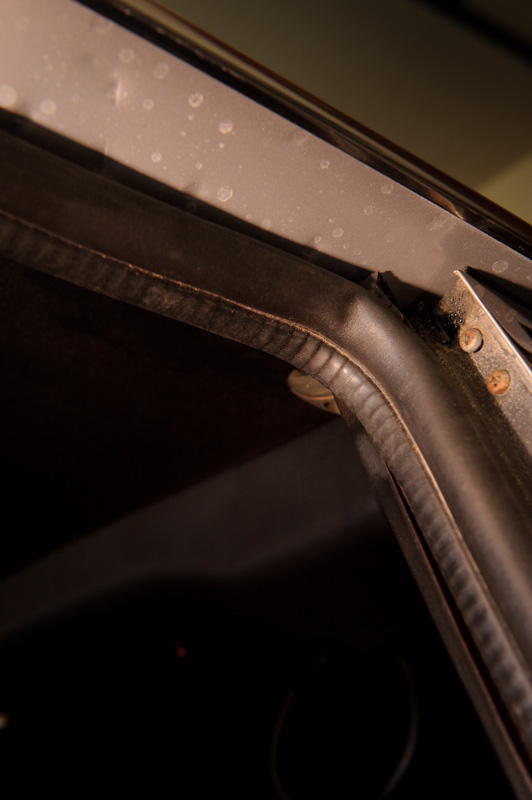

Any chance of some pics showing how you handled your 90° angle? I have read of different ways but never any visual to back up the written. I for one would greatly appreciate it! :classic:
Here is the 90° at the top of the door...
Here is a picture of how it fits on the hatch...
