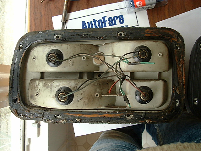

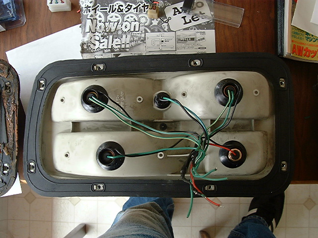

This is going to be a couple posts long in order to post pictures and explanations.
If you look at the rear tail lights on the 240, you will note that there are actually 5 bulb openings, not just the 4 everyone is aware of.
This is even more evident in the two pictures I'm posting.
The first picture is the back of a set of tail lights from a U.S. car.
Please note that the wiring is for 4 bulbs, but that there is a gray colored plug in the middle top, between the two bulbs.
Ok, now you guys know the light I'm talking about.
It took me some time, but I finally had someone respond and tell me that these are lights that get turned on when you park your car on the street, i.e. curbside. And that you must illuminate the side of the car which is on the street side versus the side walk side.
I'm not sure about the reasoning for this, but that's the story I was given.

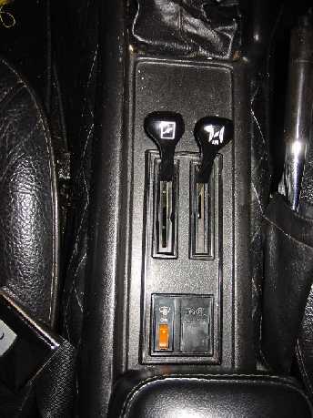

So, that means a double switch. The location of that switch is on the console. At least on the EARLY 240 consoles.
Here's a picture of the panel on the console I am referring to.
You will note that this car has the Choke, the HAND THROTTLE, (which is a SELDOM seen item in the U.S., although not non-existent), the second generation Rear Window Defog switch, (because it's the illuminated variety, the first generation had a non-illuminated switch), and lastly, the space for this parking light switch I'm referring to.
Note that the hole has been filled in with this 1" x 1" black plastic plug. This is the same plug that I've seen on dozens of 240's.
What I'm hoping to get out of this post, is that someone will be able to post either a picture of the ACTUAL switch, so that I can try to find a similar, OR that someone will admit to having a spare or knowing where to get one and willing to help me obtain this.

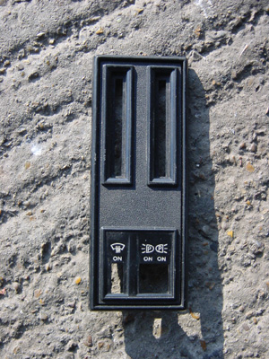

Right, I went over to the garages yesterday and took the ZG for probably its last run of the year ( putting it away for the winter now ). The rented garages are a good 30 minute drive from home.
I had a dig through the parts for the 1970 Japanese-market project car too, and only managed to find the actual switch panel -not the switches themselves ( although I think I know where they are now that I remembered ). As far as I can remember Nissan used the same switches - but just a different panel. Therefore the actual switches ( they are a pair in one unit ) could be had from either the early or later type. Sorry Enrique, I do not think I have a spare of either.
I took some photos which you can see below. The "early" type is naturally out of the console and out of the car ( the car is in the paint shop ) but the "later" type is pictured in situ in the ZG.
Enrique, I'll send you some higher resolution copies direct.
Alan T.
Here's the "early" type panel:
