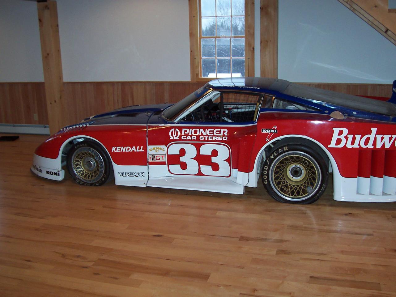

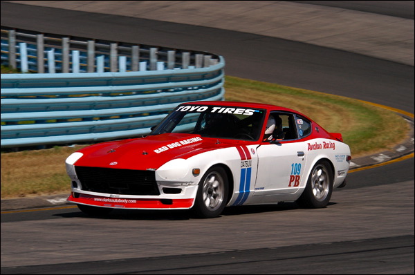

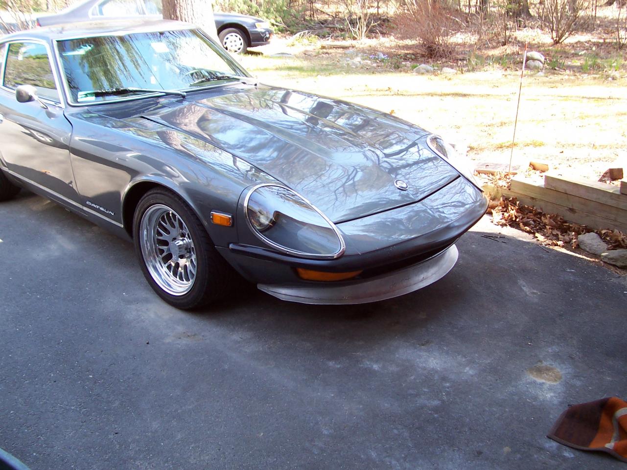

I know a bit about low as my street 240 sits just 5.75-inches (at front rocker and 6.10 at rear), the race car at just 5 and 5.75 respectively and the BSR/Newman 280ZXTT sits a mere 3 inches (with air in the tires).
The concept of just cutting and liking the look is one thing, being able to drive it and drive it fast is a whole different thing all together....
Hell, getting them on and off a trailer is a pain.
