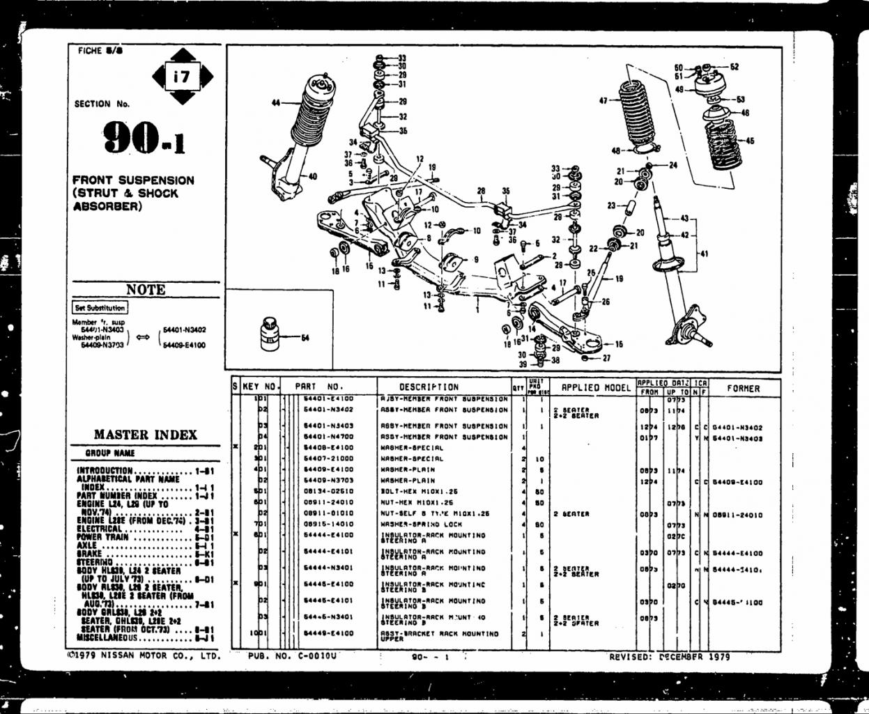

According to the Workshop manual the torque setting for the "Transverse link mounting bolt" is 79.6 to 94 ft lbs... I am feeling that this is a lot. Can anyone confirm that this is correct?
Also I need to confirm that this is for the nut that goes on the end of the bolt that has half of the threaded shaft missing that goes thru this bushing (#14 in the picture below when it is installed in the transverse link):
The transverse link (part 16) and the nut to torque is number #18
Do I have this all correct?

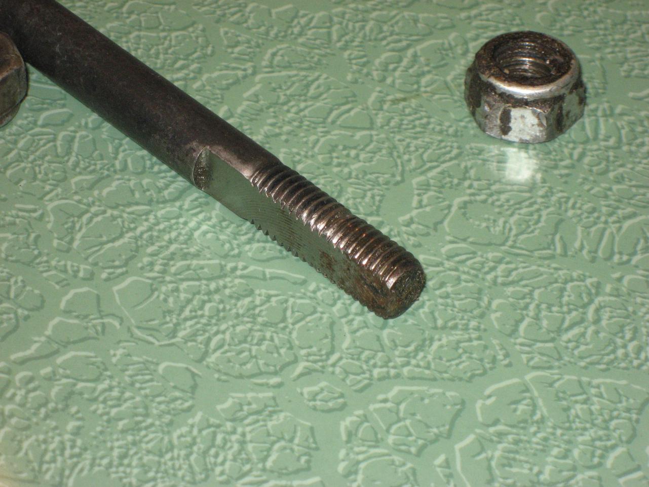

So I stripped the nut (and I think the bolt). Am I royally screwed or is there a source for this odd bolt?
Anyone know the thread pitch/diameter on these?

I made note of the part numbers for these the other day. I need some in the near future also.
Bolt - 54436-E4100
Nut - 08912-84410
Washer - 56114-09400
Try your local Nissan Parts Dealer first.
