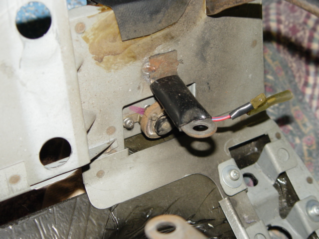

Here are some pics of it from the top side.
I hope these help, good luck!

The pictures that Terrapin Z provided show the rheostat well. Those two phillips screws and the knob on the underside need to be removed before you can push the rheostat UP into the backside of the dash to remove it. Part of the problem in pushing it UP into the backside, is that the Tach itself, and the Hazard Switch wiring can get in the way.

When you look at Terrapin's photos, the one on the right shows you the backing plate for the Hazard Switch and Cigar Lighter which should allow you to "see" what you're working on.
