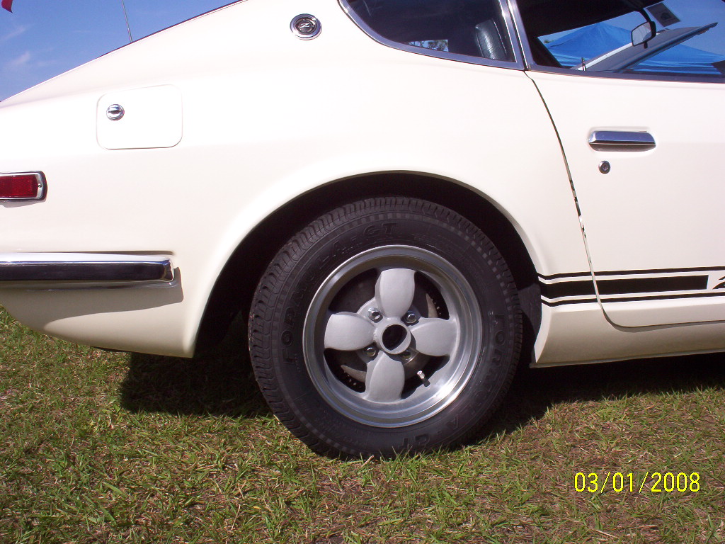

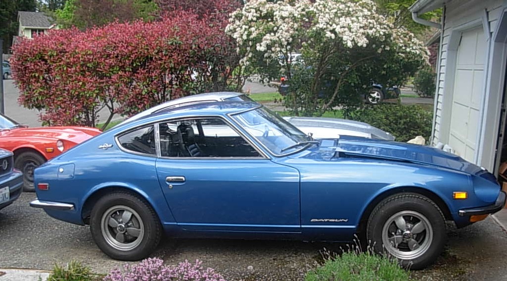

Here are a couple of pictures of the Shelby "libre style" wheels on two of my cars.
-Mike
