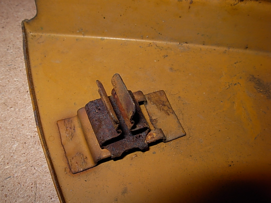

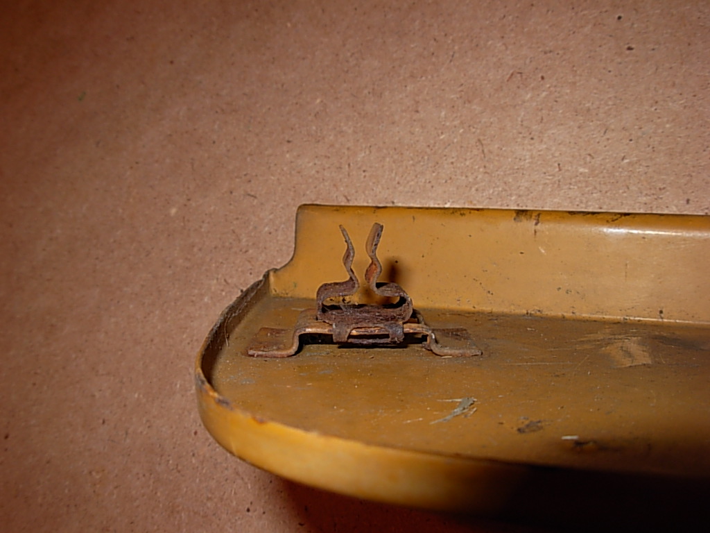

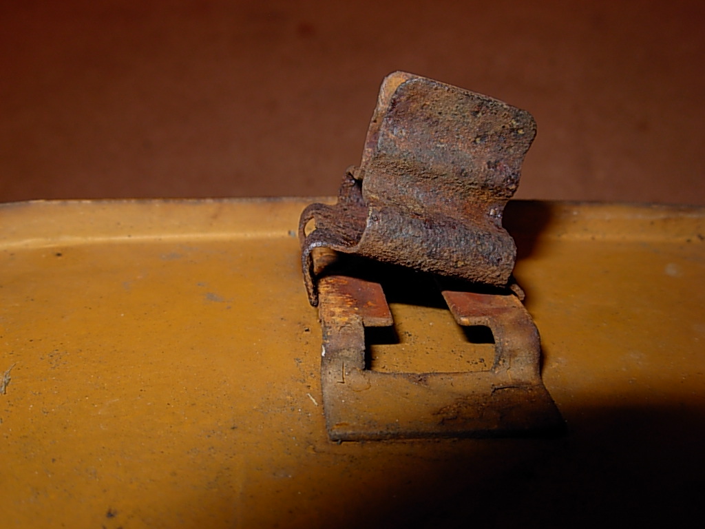

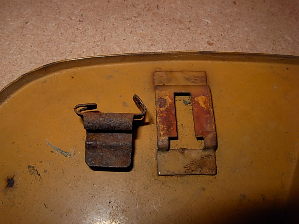

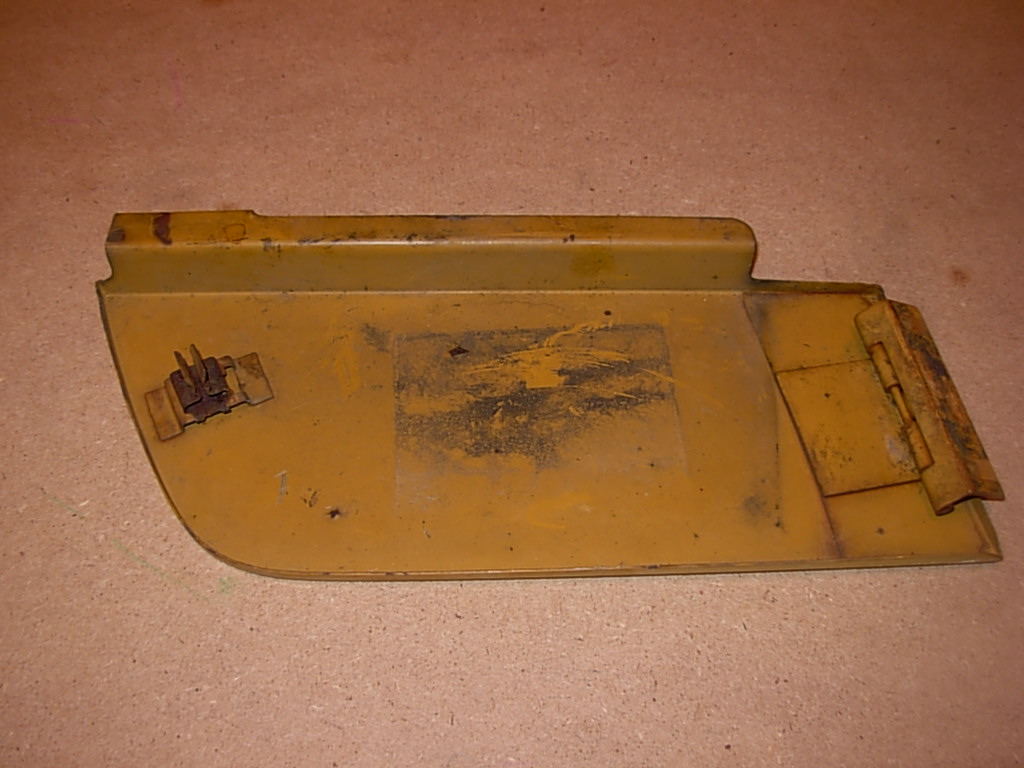

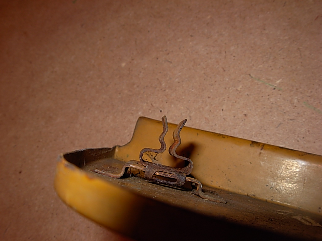

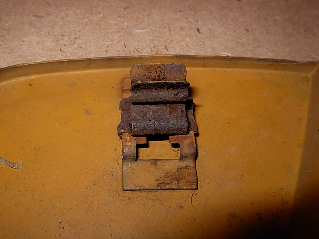

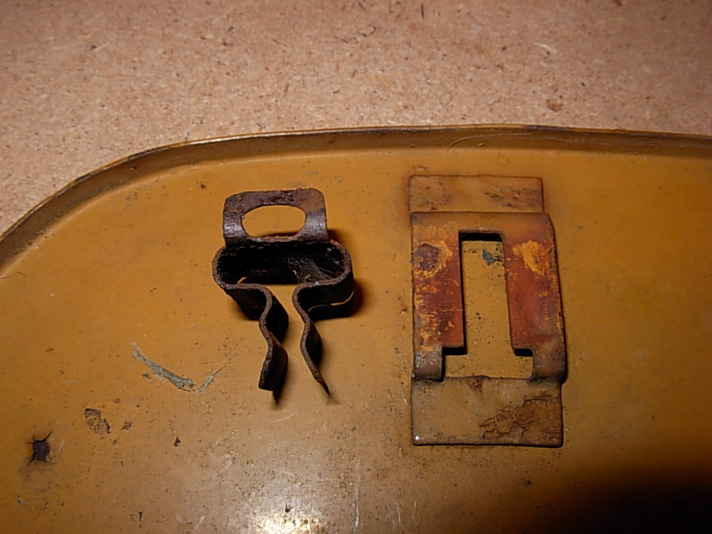

Here is an interesting add on clip that I found on a 1/70 production car. Only one inspection lid had it. The other side had remnants of a plastic clip. This looks like it was made for this purpose, so I don't think it was some type of generic replacement. It fits loose enough to be able to slide up or down, like the plastic clips do, in order to adjust to variations in the fender attachment point. I had to pry one side back with a screw driver to get it off.
I wonder if it was used as a replacement by Nissan at some point after the switch was made to the attached metal clips on the lids?
