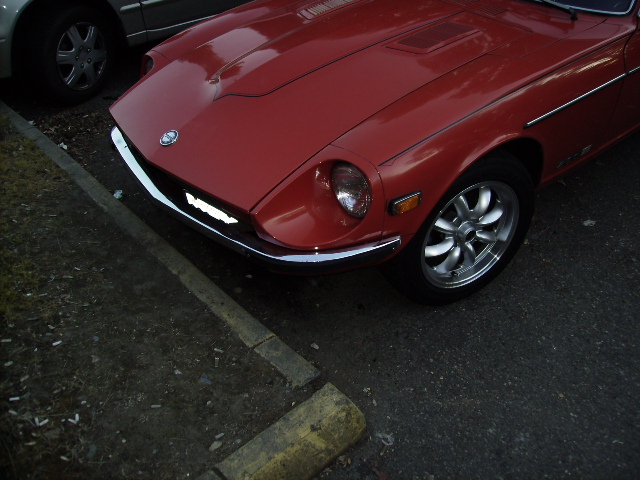

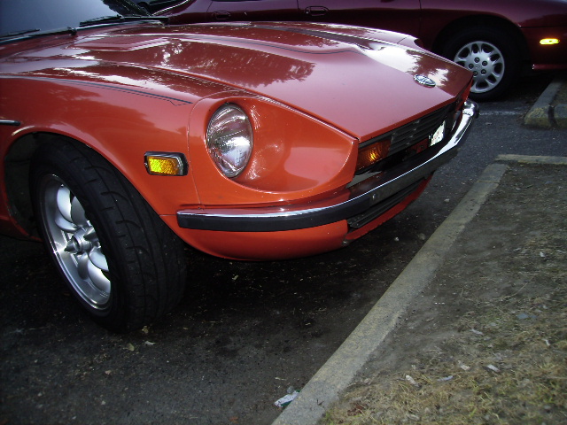

Just about finished installing my 240z front bumper, replacing the large & heaviy stock 280z bumper. Just need to pick up some nylon spacers for the bumper end bolts tomorrow from lowes. I retapped the end bolt captive nuts to clean up the threads (they are indeed 6 x 1 metric.
Fabricated the new main brackets from 1.5" x 1/8 alluminum stock, drilled & slotted them for a small amount of adjustment, & installed them with new stainless hardware. Drilled 1 new hole for the front of the brackets & utilized the stock rear hole for the back location.
Now, on to the back bumper .... even more fun!

Nice job S30driver, You did fine job cleaning up that bumper and fitting it to your 280.
I applaud your efforts.
That looks so much better than the stock bumpers. IMHO
Thank you
and a big thanks for the great deal on the bumpers Terrapin!
I also cleaned up the back of the bumper & applied POR 15 to keep it from rusting there.
It was a fun project with a very satisfying end result.
I used stainless bolts with a nylon spacer & rubber washers for the bumper ends after chasing the threads with a tap. Tough to get to those bolts inside the fender, but do-able. Nice & solid, finished this morning after picking up the washers etc.
Dave, Terrapin Z gave me a great deal on them.
Did alot of prep & cleaning, will probably get them re-chromed this winter.
But they are pretty presentable for now.
