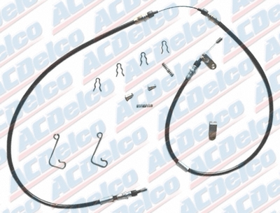

Posted July 10, 201014 yr comment_324871 I bought an aftermarket parking brake cable from Rockauto,com I couldnt justify the $300 + for a stock one from MSA, the aftermarket was around $65. My question lies with the springs that came with it. The stock cable has the springs aft of the clevis pin. The replacement had the springs inside a plastic bag. The clevis pins are groved on the side for the cable to slide through. I cannot figure out how I am supposed to get the spring on the cable. It is too small in diameter to fit over the pressed fitting on the cable end. Any ideas? Edited July 10, 201014 yr by MEZZZ Link to comment https://www.classiczcars.com/forums/topic/36429-aftermarket-ac-delco-parking-brake-cable-question/ Share on other sites More sharing options...

February 27, 201114 yr comment_347528 I didn't want to spend several hundred dollars on a parking brake cable either so I bought on from Rock Auto. They had two that allegedly fits a '76 which I bought a couple of weeks ago... RAYBESTOS Part # BC92952 74 1/4" Overall Length $56.79 NISSAN 280Z (1975 - 1978) NISSAN 280Z 2+2 (1975 - 1978) NISSAN 280ZX (1979 - 1980) NISSAN 280ZX 2+2 (1979 - 1980) WAGNER Part # BC122537 Part {#F122537} $78.79 NISSAN 280Z (1975 - 1977) NISSAN 280Z 2+2 (1975 - 1977) I bought the Raybestos cable which didn't come with all the pieces displayed in the picture. (circled in blue) The clevis pins, cotter pins, one of the hangers and the end piece that connects to the brake lever. I reused the existing clevis pins with new cotter pins and had to modify the end pieces on the existing cable to work with this one. I'm disappointed that parts were missing but so far so good on functionality. Edited February 27, 201114 yr by yor5150 Link to comment https://www.classiczcars.com/forums/topic/36429-aftermarket-ac-delco-parking-brake-cable-question/#findComment-347528 Share on other sites More sharing options...
