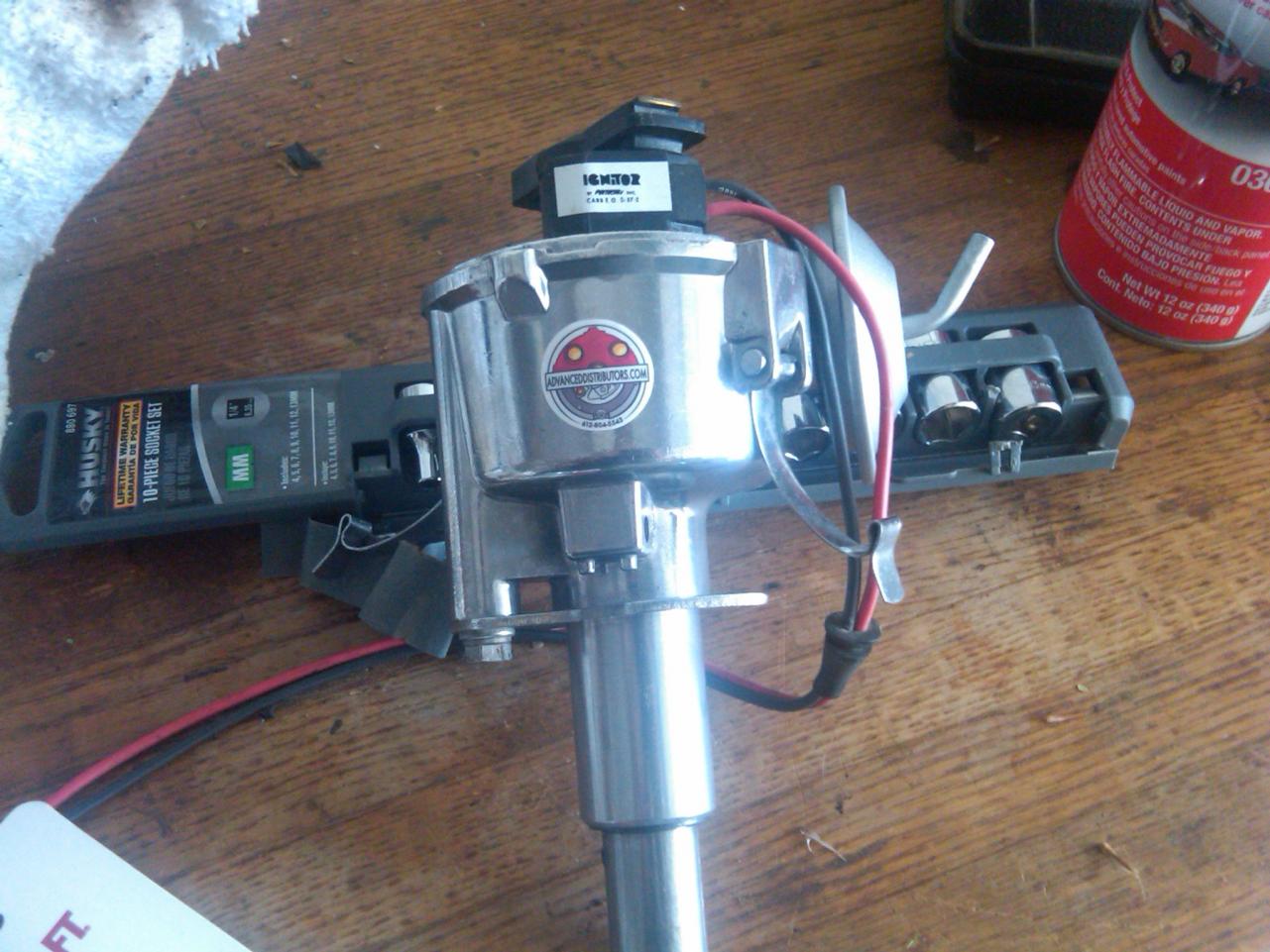

I had the same problem with the vacuum advance on my '73 240Z. Since my engine is stock (except for the Pertronix and coil) I decided to have the original distributor built by Advanced Distributors in MN. They specialize in rebuilding and recurving distributors on collector vehicles, and I was very pleased with their work. The case was polished inside and out, and my car runs much better at low rpm.
The cost was about $95, but the work took about three weeks. Highly recommended.

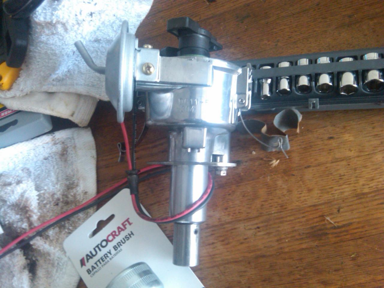

So, I took the two screws out that connect the advance module to the distributor body and when I pull the module away, the inside of the distributor swivels easily. I didn't disconnect the arm, but I think that this confirms that the issue is indeed the module itself, not the distributor. Would you guys agree? If so, is there a way I can free this thing up? I've searched and searched, but can't find anywhere on the internet that shows how this thing works...

Ok, got another dizzy on ebay for 99cents plus shipping and, although it's supposedly good per the seller, the advance doesn't work on it either. I pulled it apart thinking I'd try to clean it up and fix it, but am having an issue. When I take apart the advance module and remove the spring, I can make the rod that the spring attaches to retract by sucking in as well as push back out by blowing, but with the spring attached, I cannot. The condition of the baseplate ball bearings is going to be irrelevant if I can't make this thing work. Is it possible that there's too tight a spring on this or am I just not sucking hard enough? I suppose I could borrow my buddy's vacuum dealie (it's got a gauge and a pump) to see how many PSI are required to pull it in, but it shouldn't be that much if it just uses engine vacuum...
