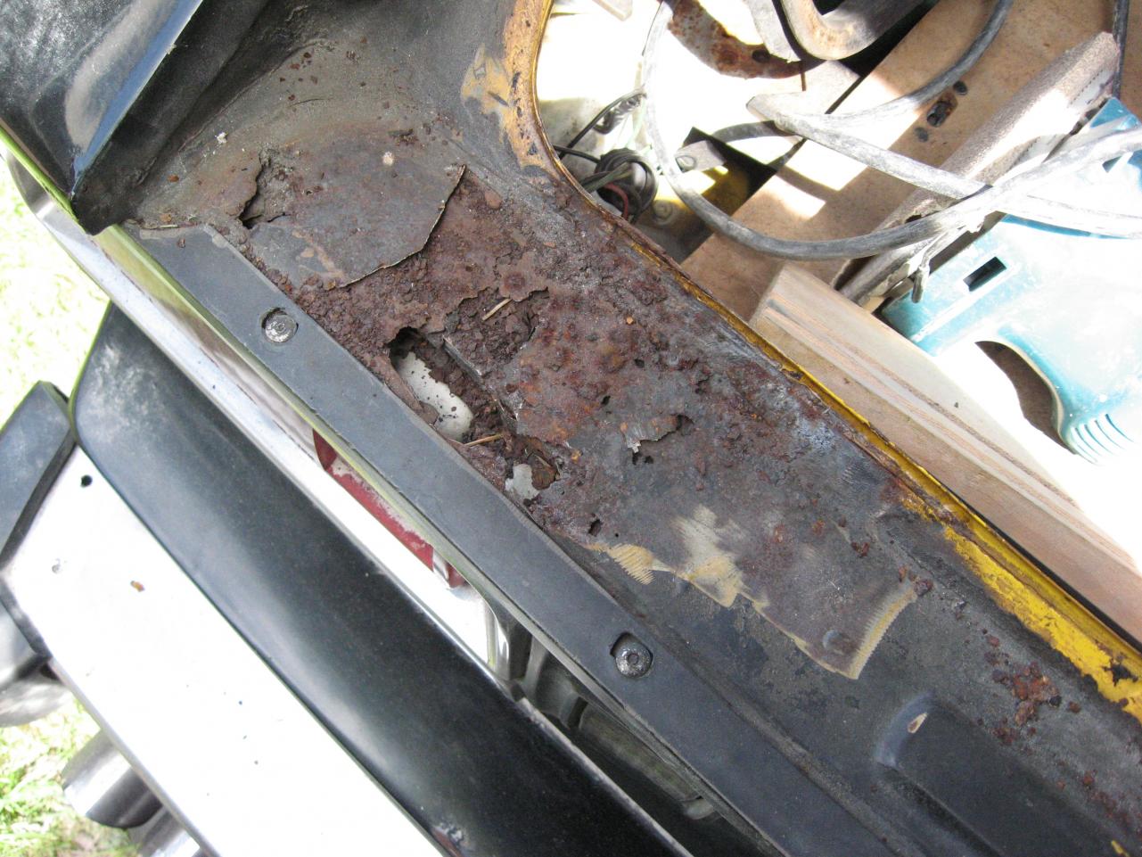

I have a '72 and am in the process of replacing some rusted metal. I have read of the possibilty of bonding the under-hatch (above tail lights) repair panel using one of the high-tec body adhesives. Has anyone done this? I thought about using this method along with spot welds on the braces coming off the rear panel above the tag. Seems like this would eliminate the possibility of rust after welding in hard to treat areas. Any thoughts? Does anyone have one of these panels made by Nissan th
