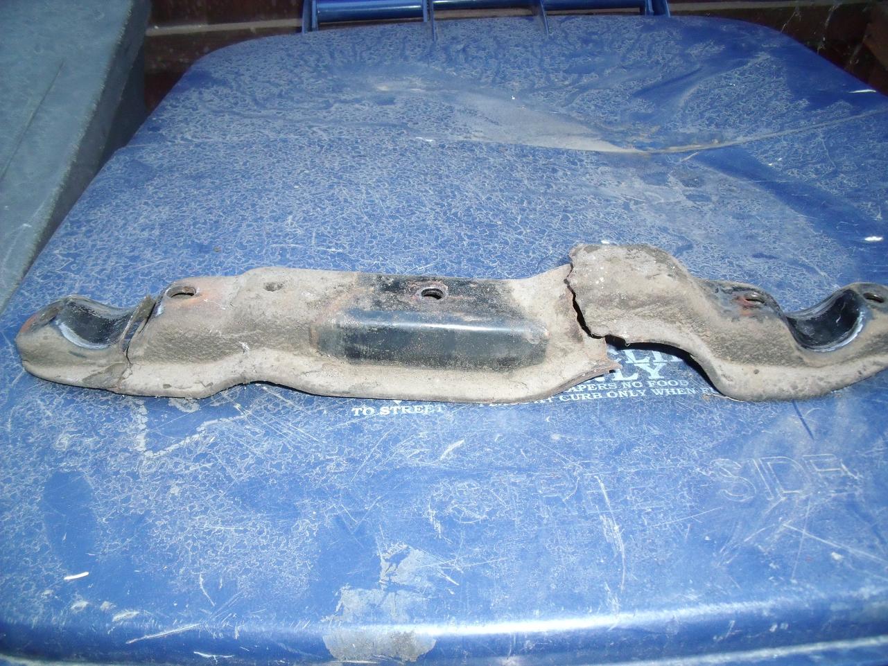

Posted July 23, 201014 yr comment_326249 MY body shop removed this rusted and busted piece from my 72 Z. Is this the rear transverse link mount? What year should I replace it with to accomodate an R200 differential? Thanks Link to comment https://www.classiczcars.com/forums/topic/36585-rear-transverse-link-mount/ Share on other sites More sharing options...
July 23, 201014 yr comment_326251 Another 72' or any similar year. That looks like the one in my 70 and my 74' and they both have R200's Link to comment https://www.classiczcars.com/forums/topic/36585-rear-transverse-link-mount/#findComment-326251 Share on other sites More sharing options...
July 23, 201014 yr comment_326269 That is the front diff mount. Any year will work (70-78). The late 260 to 280 are slightly different in the strength of the unit (more steel reinforcing) and a larger radius to the exhaust pipe clearance curve on the drivers side of it.Great time to get Zs-ondabrain's R/T diff mount too if you're not already on the list. Link to comment https://www.classiczcars.com/forums/topic/36585-rear-transverse-link-mount/#findComment-326269 Share on other sites More sharing options...
July 23, 201014 yr comment_326297 Makes me wonder what busted it. I'd look very carefully at the body shell and the rest of the suspension. Something really whacked it to do that much carnage.I also have a R200 in my '72 with the stock mount. Edited July 23, 201014 yr by GreenZZZ +R200 Link to comment https://www.classiczcars.com/forums/topic/36585-rear-transverse-link-mount/#findComment-326297 Share on other sites More sharing options...
July 23, 201014 yr comment_326309 Wow, that looks nasty.Looks like a crack is beginning on the opposite outboard side too.Piece doesn't look that rusted, and not bent from someone trying to forcibly remove. Metal fatigue? I don't know but I'd be curious to find out what caused it. Link to comment https://www.classiczcars.com/forums/topic/36585-rear-transverse-link-mount/#findComment-326309 Share on other sites More sharing options...
July 23, 201014 yr Author comment_326314 It's actually in 3 pieces. Only the bolts were keeping it in place. I guess I know what that 'clunking' sound was in the back of my Z.... Link to comment https://www.classiczcars.com/forums/topic/36585-rear-transverse-link-mount/#findComment-326314 Share on other sites More sharing options...
July 24, 201014 yr comment_326317 That mount looks like it has suffered the kind of metal fatigue damage found in extremely cold climates, not California. I agree with Bart, it would be a good idea to give it a good look-over for other damage or loose parts that could have contributed to this. Link to comment https://www.classiczcars.com/forums/topic/36585-rear-transverse-link-mount/#findComment-326317 Share on other sites More sharing options...
