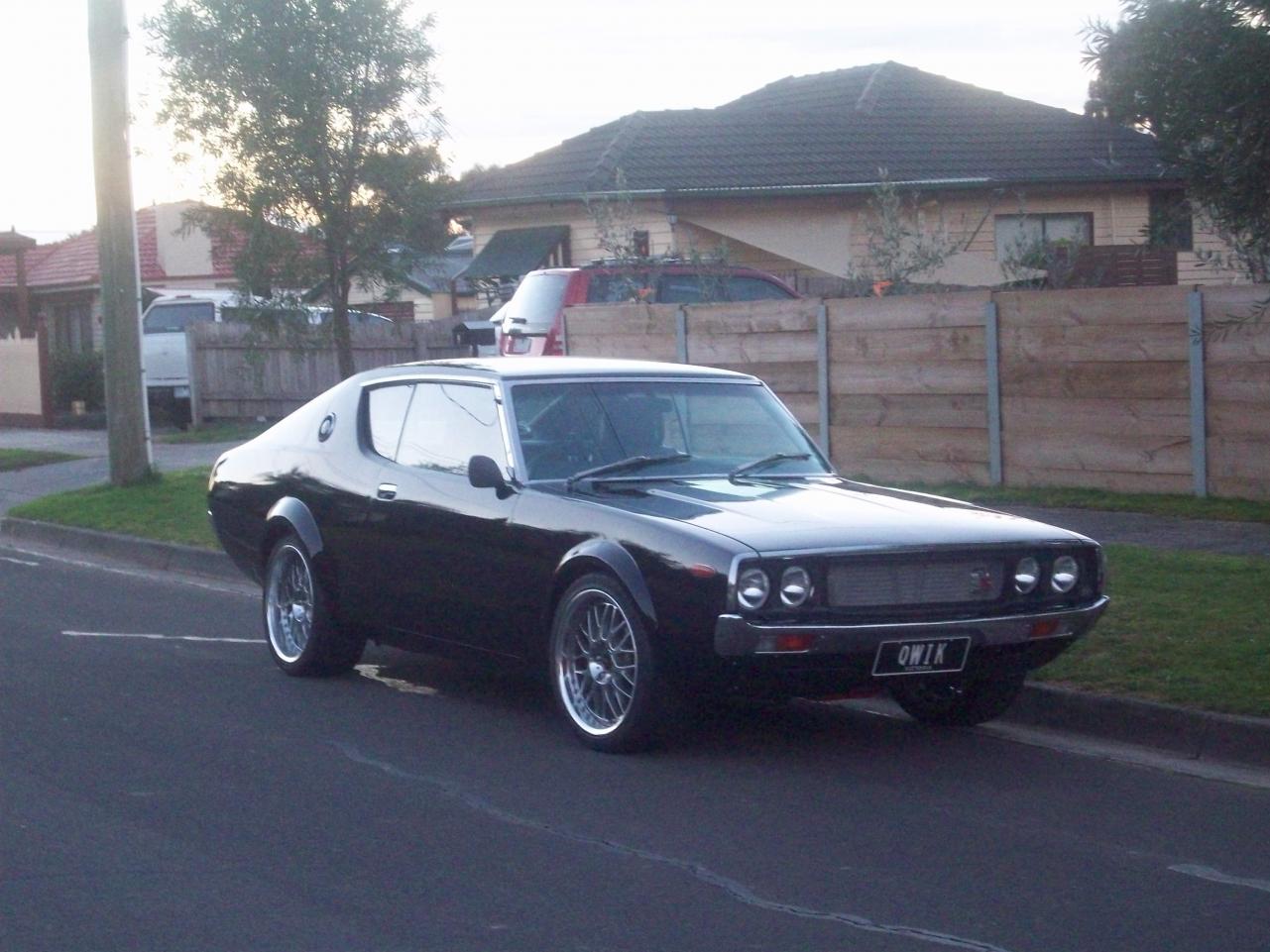

Posted July 25, 201014 yr comment_326388 hey guys, as of last friday my car is on the road! Hope to drive it to the nationals...... Link to comment https://www.classiczcars.com/forums/topic/36603-engineered-and-registered/ Share on other sites More sharing options...

July 28, 201014 yr comment_326673 hey guys, as of last friday my car is on the road! Hope to drive it to the nationals...... Congratulations! The finished job is a credit to you:beer: Link to comment https://www.classiczcars.com/forums/topic/36603-engineered-and-registered/#findComment-326673 Share on other sites More sharing options...
