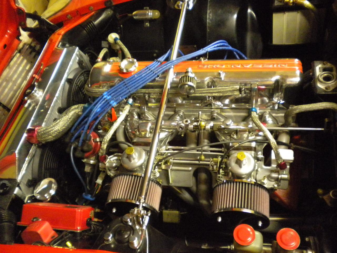

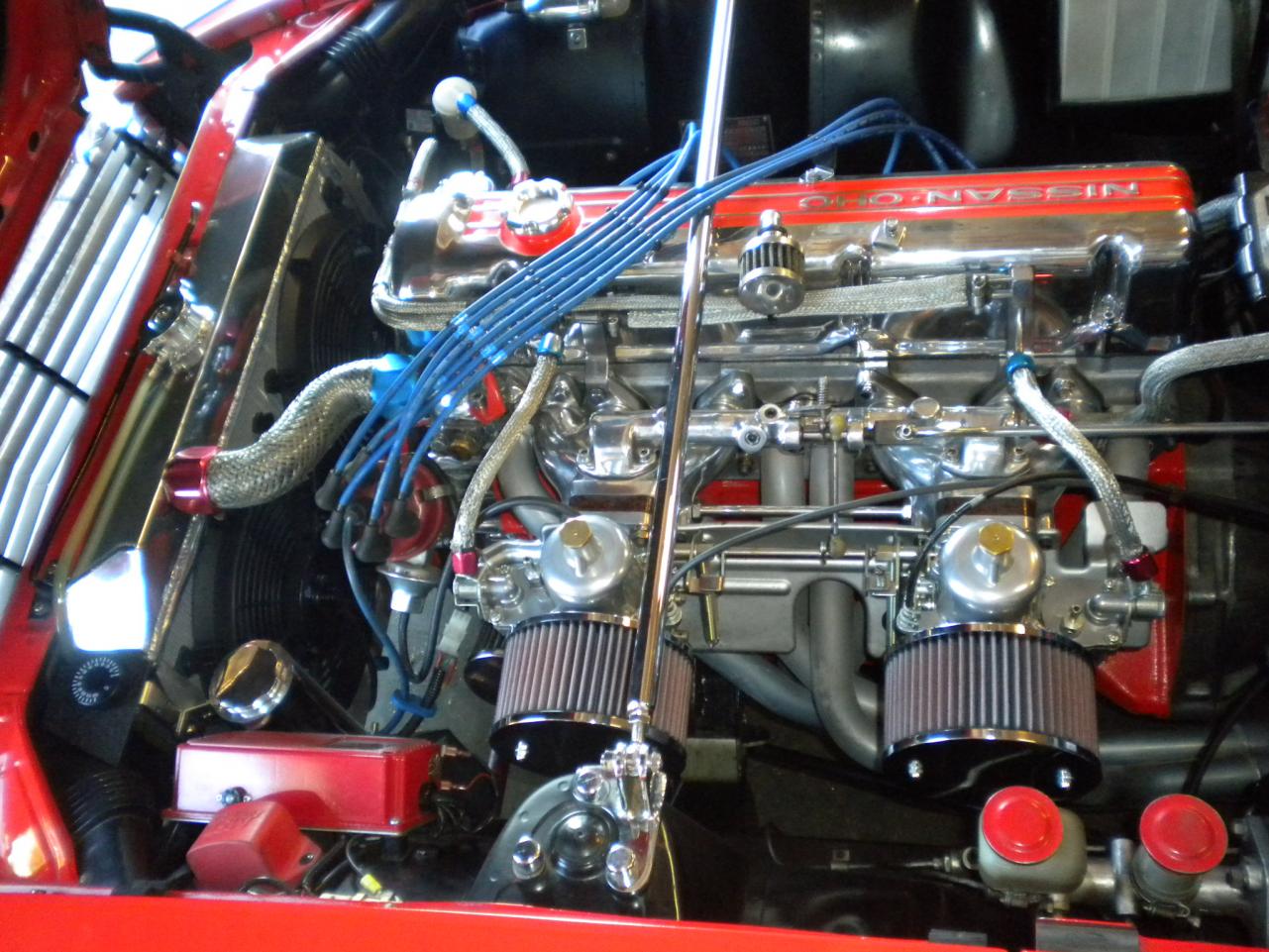

July 29, 201014 yr comment_326745 A 1-1/2" throat stub stack will essencially "Choke your carbs." You need the 1-3/4" wide stacks and air cleaner assemblies that will acompany the 1-3/4" SU's. I recently had Steve and Bruce at ZTherapy instal a brand new set of SU's onto my rebuilt 2.6 Liter in my 70' 240Z. Those, in combination with the MSA K&N filter kits (Very similar to the ones pictured above) and Air horns cut from a mangled stock air cleaner assembly, Have been ABSOLUTELY AWESOME!!! I Won't go back to the stock box, there just ain't no convincing me otherwise. Hope the other info helps. Below is my new SU's and air cleaners. Dave Edited July 29, 201014 yr by Zs-ondabrain Link to comment https://www.classiczcars.com/forums/topic/36632-air-cleaner/#findComment-326745 Share on other sites More sharing options...

July 29, 201014 yr Author comment_326754 A 1-1/2" throat stub stack will essencially "Choke your carbs."You need the 1-3/4" wide stacks and air cleaner assemblies that will acompany the 1-3/4" SU's.I recently had Steve and Bruce at ZTherapy instal a brand new set of SU's onto my rebuilt 2.6 Liter in my 70' 240Z. Those, in combination with the MSA K&N filter kits (Very similar to the ones pictured above) and Air horns cut from a mangled stock air cleaner assembly, Have been ABSOLUTELY AWESOME!!!I Won't go back to the stock box, there just ain't no convincing me otherwise.Hope the other info helps. Below is my new SU's and air cleaners.DaveLooks great....I have been wire brushing the stock air box 3 layer's of paint Orange,Blue,Yellow,not sure who painted it but it was sloppy.How much was that set up?Thanks for the fast respond all.I was going to buy them on ebay.I also was going to buy the set at zstore but 240.00 with tax and shipping was too much Link to comment https://www.classiczcars.com/forums/topic/36632-air-cleaner/#findComment-326754 Share on other sites More sharing options...
July 29, 201014 yr comment_326763 ZTherapy Carbs...... $630 for the setK&N Air Filter kits ....$130 for the setValve cover and Block filters $35Radiator and fans ....$230Aluminum Overflow...$55Dave Link to comment https://www.classiczcars.com/forums/topic/36632-air-cleaner/#findComment-326763 Share on other sites More sharing options...
