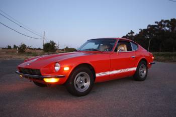

After a 15 year hiatus of Z car ownership, I have returned to the fold.
A friend found this nice example for me. It's an original paint ( 110 paint code ) 1972 240 with 90K original miles. It's typical of a fully dealer-optioned Z car. It was fitted with A/C, the 240Z sticker on the sill, Amco towel bars front and rear, Amco floor mats and those infernal slotted mags at the dealer.
It's in pretty good shape. I fixed a fuel leak and then drove it home 1100 miles.
I had to remove the Amco bumper guards, and while I was there, I removed the overriders. Ahhhhh. MUCH better.
